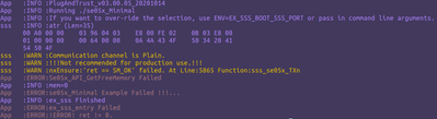

Hi, I am writing a program that calculates a shared secret on the NXP SE050 and then exports the shared secret. For this, I am using both "sss_derive_key_dh" and "sss_key_store_get_key" to export the key.
The problem I am having is that when I try to run "sss_key_store_get_key", it fails. I was able to find an error code that it produced, 6986, which states "kSE05x_SW12_COMMAND_NOT_ALLOWED - Command not allowed - access denied based on object policy".
While trying to debug this I looked into and ran the ex_ecdh example. This examples runs but I've discovered the "sss_key_store_get_key" call runs "sss_openssl_key_store_get_key" instead of the "sss_se05x_key_store_get_key" that I am hoping to run.
Would someone be able to provide an example that runs  "sss_derive_key_dh" and the se05x version of "sss_key_store_get_key"?

Hi @ethanlooney ,
Did you implement the application based on the latest MW? Is it possible to share your code for a review?

ethanlooney
I belive I am running into the same issue as this post:
https://community.nxp.com/t5/Secure-Authentication/Create-Crypto-Object-error-0x6985-conditions-not-...
I am unable to run even the ./se05x_Minimal example.
How would I go about resetting the dev board in order to resolve this problem?

Kan_Li
Hi @ethanlooney ,
Is it possible to unlock more logs for analyze? Please kindly refer to "SE-PLUG-TRUST-MW/simw-top/doc/stack/logging.html" for more details.

ethanlooney
Hi Kan,
I've enabled debug level logging for all and have attached a copy of the terminal output while running ./se05x_Minimal.
Please let me know how to move forward from here to resolve this issue.

sss   :WARN :nxEnsure:'ret == SM_OK' failed. At Line:6291 Function:sss_se05x_TXn
App   :ERROR:Se05x_API_GetFreeMemory Failed
App   :INFO :mem=0
App   :ERROR:se05x_Minimal Example Failed !!!...
App   :INFO :ex_sss Finished
App   :ERROR:ex_sss_entry Failed

App   :ERROR:!ERROR! ret != 0.
4,712 Views
Kan_Li
Hi @ethanlooney ,
Thanks for the information! We will try to analyze the root cause based on that, and also wondering what is the platform used to run the demo, is it a FRDM-K64F board or something else?
Kan
4,709 Views
ethanlooney
Hi Kan,
The demo is being run on a raspberry pi connected to the SE050 dev board over I2C. I've tried running the demo on two different raspberry pi's with unmodified code so I believe the problem lies with the SE050.
Ethan
4,655 Views
Kan_Li
Hi @ethanlooney ,
Regarding the general communication issues it seems here is an I2C device address conflict on the bus, so would you please try to disconnect SE050 and run again, if there is still some responses there is another device on the bus with conflicting address.
Kan
