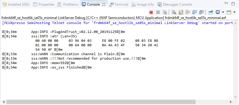

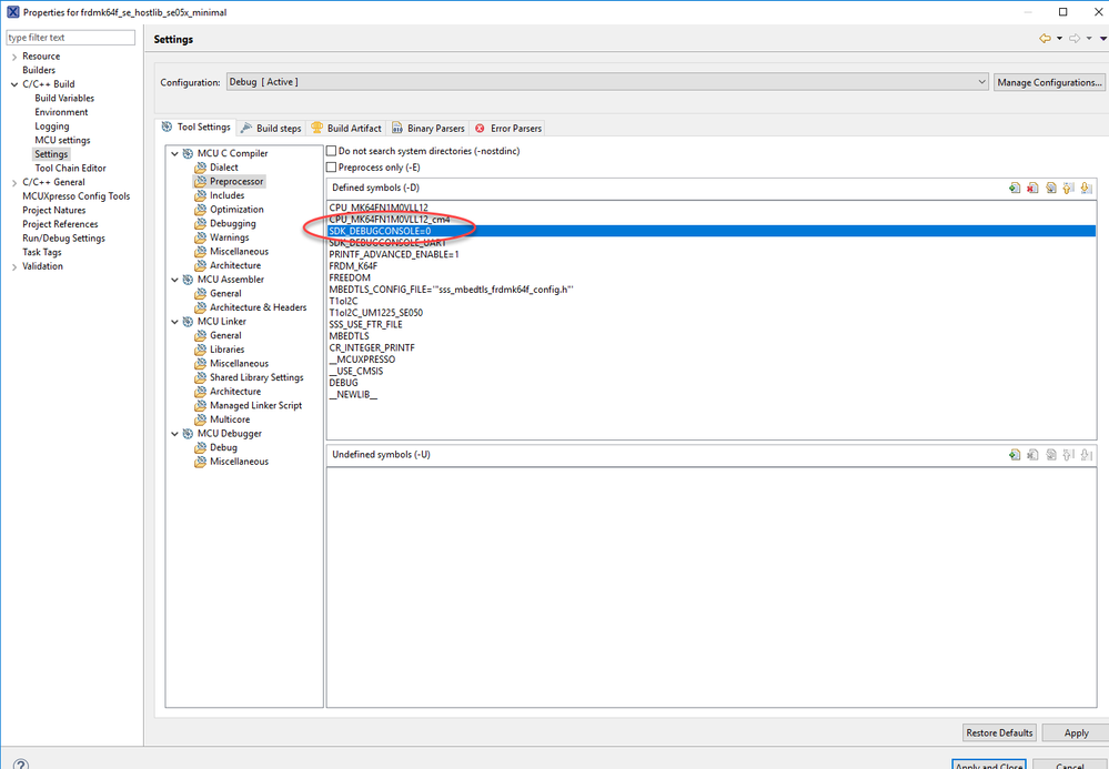

If just for debug purpose, you may use the console from MCUXpresso instead. Please kindly refer to the following steps for details.
1.Set SDK_DEBUGCONSOLE as 0.
2. Use semihost lib instead.
3.Rebuild & debug the project and you will see the debug info like below:
