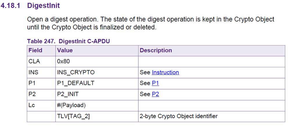

Hi Guys,
I have an input string say 1000 chars long and I'd like to generate a hash value for it. I initially used the DigestOneShot function by sending in the input string by chaining them. Unfortunately there is a limitation to the input APDU length of only 889 bytes total as per this Datasheet. So is it only possible to use Digest Init-Update-Final operations instead of DigestOneShot ? My input may go up to 2000 chars in the future.
My master hardware is STM32 and target is SE050. I've created the 2 byte crypto object required for the Digest Init-Update-Final operations. Now my question is in what sequence do I call the Digest Init-Update-Final functions. Currently my code does the following (All below operations are performed session-less):
1. Soft reset
2. Select SE050 applet
3. Digest Init
4. Digest Update
5. Digest Final
For instance if I have more data to be updated, then should I do the steps 1 & 2 for each Digest Update or is it sufficient that I do the steps 1 & 2 only once?
Edit: I created the crypto object required for the Digest operations.
Object ID: 00 05
01: CryptoContext - CC_DIGEST
04: Crypto object sub-type - DIGEST_SHA256
Now when I call the Digest-init function, i'm able to initialize successfully.
The response is 90 00

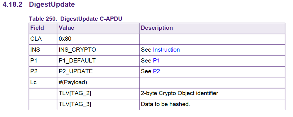

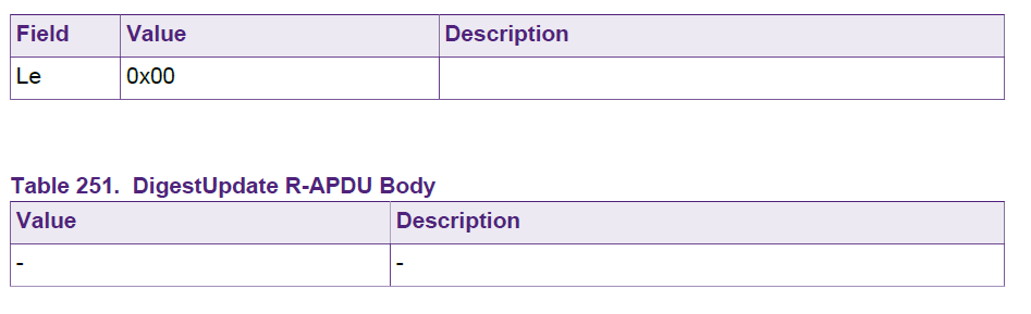

But when I call the Digest-update function with the input data, the chip throws me the "conditions not satisfied" response.
The response I get is 69 85 always. I double checked my input commands and they are according to the Digest-Update structure explained in datasheet. All the functions are called without sessions and communicated via I2C protocol. Am I missing any other key info here like is there a minimum size of input data that is required for the Digest-update function or can it handle any size of data every time ?

Hi michaelsalfer‌,
Thanks for helping me out with this. Actually the mistake was on my I2C packet part. The PCB byte was causing this issue. Now that I've corrected it and I'm able to update the input data for generating the hash value. Thanks a lot!

badhri_radhakri
Hi Kan_Li‌ the issue was with the incorrect PCB byte. Now I've corrected it and its working fine. The APDU commands were correct all the time :smileyhappy:
