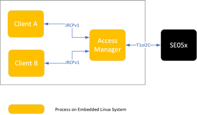

We built the "accessManager" binary utility with the below mentioned cmake configure options.
do_configure() {
cd ${B}
cmake -S ../simw-top \
-DWithSharedLIB=OFF -DCMAKE_BUILD_TYPE=Debug -DCMAKE_INSTALL_PREFIX=/usr \
-DPTMW_Host=iMXLinux -DPTMW_HostCrypto=OPENSSL \
-DPTMW_SMCOM=T1oI2C -DPTMW_SE05X_Auth=PlatfSCP03 -DPTMW_SCP=SCP03_SSS \
-DIOT=None -DPTMW_Applet=SE05X_C -DPTMW_SE05X_Ver=06_00 \
-DOPENSSL_INSTALL_PREFIX=${WORKDIR}/recipe-sysroot/usr/ \
-DPAHO_BUILD_DEB_PACKAGE=OFF -DPAHO_BUILD_DOCUMENTATION=OFF \
-DPAHO_BUILD_SAMPLES=OFF -DPAHO_BUILD_SHARED=OFF \
-DPAHO_BUILD_STATIC=ON -DPAHO_ENABLE_CPACK=ON \
-DPAHO_ENABLE_TESTING=OFF -DPAHO_WITH_SSL=ON \
-DOPENSSL_ROOT_DIR=${WORKDIR}/recipe-sysroot/usr/
Then we built a client application "se05x_ConcurrentEcc" which communicates with the "accessManager" over JRCPv1 protocol using the below mentioned cmake configuration.
do_configure() {
cd ${B}
-DPTMW_SMCOM=JRCP_V1_AM -DPTMW_SE05X_Auth=None -DPTMW_SCP=None \
After this we ran the "accessManager" utility in background.
# ./accessManager &
# Starting accessManager (Rev.1.1).
Protect Link between accessManager and SE: YES.
accessManager JRCPv1 (T1oI2C SE side)
Server: waiting for connections on port 8040.
Server: only localhost based processes can connect.
Then we ran the client "se05x_ConcurrentEcc". The client communicated well with the "accessManager" over JRCPv1 protocol. But the "accessManager" could not establish communication with the se05x device over I2C interface. The log is as mentioned below.

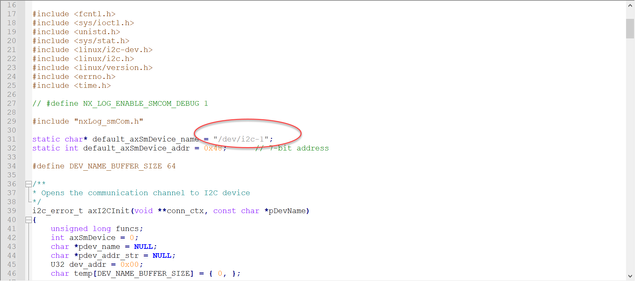

Hi @ajitsj3 ,
Looks like AccessManager keeps using the default settings, would you please modify the default settings in the file of "simw-top\hostlib\hostLib\platform\linux\i2c_a7.c" as below?
Please kindly let me know if the problem is still there.

ajitsj3
Hi @Kan_Li ,
As suggested by you, I changed the i2c device name to "i2c-0" in the file "simw-top\hostlib\hostLib\platform\linux\i2c_a7.c". After that the accessManager started working and it is communicating with SE05x as well. Thanks for your support.
Thanks and regards
Ajit S J

Hi @ajitsj3 ,
It is not the right way to run both AccessManager and the client applications like that , as you could not make sure AccessManager set up all things before the client connects with it. Please use a single console for each of them and run AccessManager at first.
Hope that makes sense,

Hi @ajitsj3 ,

Hi @Kan_Li ,
Could we configure the I2C device name as "i2c-0" without making changes in the code?
Because in other hardware device we might have to use "i2c-1" as I2C device name.
So please let me know if there is a way to send this I2C device name as argument for accessManager?
Thanks and regards
Ajit S J
18,084 Views
Kan_Li
Hi @ajitsj3 ,
No, so far AccessManager just use the default I2C device name without acceptance for external parameter, but you may try the solution as I mentioned in https://community.nxp.com/t5/Secure-Authentication/AccessManager-I2C-device-name-configuration-using... , so that you needn't modify the source code frequently.
Hope that helps,
