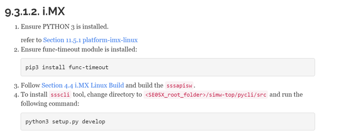

Hi @James1126 ,
As far as I know, the lib of "libsssapisw.so" should be copied to /usr/local/lib by "make install" command, have you done that when you pre-compiled the MW in your Linux PC (Yocto build)? and have you run the command "ldconfig" after that?
and have you prepared the following steps before install ssscli tool?

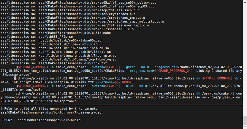

I am wondering if you have built libsssapisw.so successfully , please kindly refer to the following for details.
pi@raspberrypi:~/se05x_mw_v04.02.00_20220701_151557/simw-top_build/raspbian_native_se050_t1oi2c $ cmake --build . --target sssapisw
[ 4%] Built target mwlog

[100%] Linking C shared library libsssapisw.so
Copy dll to /home/pi/se05x_mw_v04.02.00_20220701_151557/simw-top/tools
[100%] Built target sssapisw
pi@raspberrypi:~/se05x_mw_v04.02.00_20220701_151557/simw-top_build/raspbian_native_se050_t1oi2c $ ssscli --help

The difference here is you native compiled sssapisw in Raspi. I cross-compiled it in my Linux PC.
6,054 Views

BTW, have you run the command ldconfig after "make install"? Have you done it natively or during the cross-compiling? Please kindly clarify.
Kan

Hi @James1126 ,
I just tried it on imx6ul platform and built libsssapisw.so only before building ssscli, it works as well. Please kindly refer to the following for details.
root@imx6ulevk:~/se05x_mw_v04.02.00_20220701_151557/simw-top_build/imx_native_se050_t1oi2c# cmake --build . --target sssapisw
