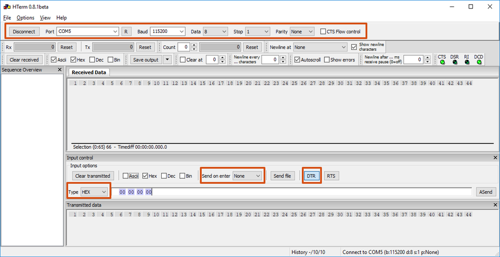

michaelsalfer
Hello Julian,
On Windows e.g. HXTerm has to capability to set DTR using a GUI and being able to enter the commands in hex format.
The Plug&Trust MW also contains the apdu-player example which builds on windows and linux:
Short documentation:
  • simw-top/doc/demos/apdu_player/Readme.html
Example Build folder on windows - needs to be built explicitly, project for build gets e.g. on windows created in this folder:
  • simw-top_build\se_x86\demos\apdu_player
Kind regards,
Michael

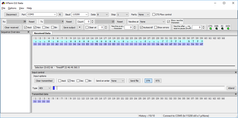

michaelsalfer
Hello Julian,
some points to be sure:
- you put the firmware a7x_vcom-T1oI2C-frdmk64f-SE050x.bin on the K64F
- the SSS examples (and ssscli) executed on the Windows PC and connected over VCOM work (not executed directly on K64F)
- you opened the correct COM port - not the Debug-VCOM, but the VCOM provided by the host-USB port on K64F
When the windows-based examples work and you connect hterm to exactly this COM-port it will work like this, here the ATR is fetched using the vcom special command 00000000:
Even if e.g. platformSCP is switched on mandatory you will get at least an error code as response.
Kind regards,
Michael
