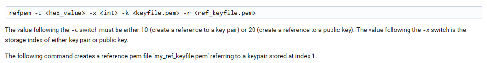

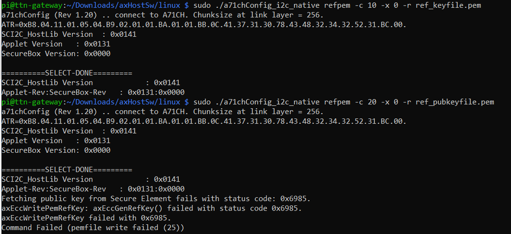

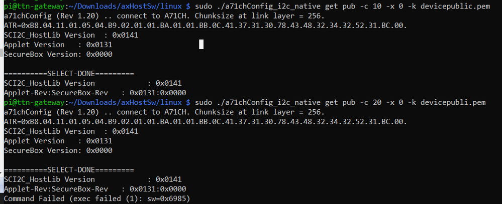

After playing a bit with the base functions, it seems that the option "-c 20" supposed to return the public key of a pair (with get pub) or the reference to a public key (using refpem) is not supported. This does not match with the provided Doxygen documentation.
What would be the correct option value then to retrieve only a public key or reference a public key of a given pair with refpem ?
I have attached below some screenshots of the command calls result with "-c 10" (works) & "-c 20" (fails) options.

Doxygen excerpt:
get pub calls:
refpem calls:

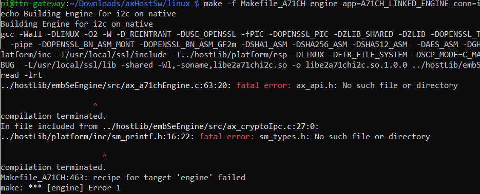

>> unable to compile the A71CH_LINKED_ENGINE as indicated on the Doxygen documentation (recipe fails)
>> recipe fails regardless of the specified build platform with sm_types.h &  ax_api.h apparently not linked properly in the Makefile under the /linux subfolder.

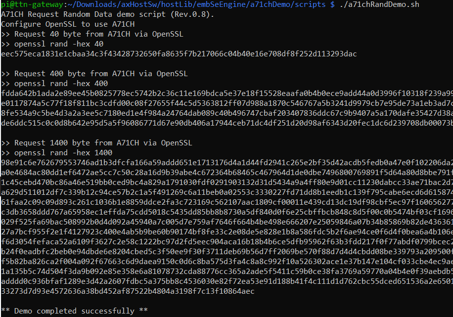

When running the ./a71chRandDemo.sh Openssl runs as if no a71ch (no connect attempt) was present and no activity is measured with the logic analyzer on the I2C bus (example from hostLib/embSeEngine/a71chDemo/scripts/):
(Followed axHostSw/doc/a71chDoxy/html/page_imx6ul_setup_openssl_engine.html guidelines)
I guess this has to do with the openssl v1.1.0j being installed while the libdev v1.0+ was used for compilation (the Host SW package does not support openssl V1.1+). I will try to see if a downgrade is feasible.

Sorry for the late reply! I just got a I.MX6UL EVK to verify your issue about "-c 20". Actually I met similar issue at first when I run get pub or refpem directly, but I finally found that is due to the pub key is not initialized in A71CH. Please try the following command in interactive mode and check if it works on your side.
>>> info pub Public Keys:         idx=0x00 n.a.         idx=0x01 n.a. >>> set pub -x 0 -h 043802B1164C30860AC913F5F997B84158C40CFFCC1D3A4359BC22574A4FC95E628933A9E95820AD6B96A1DA106BDD5D6A8E556A78AE959C59336FE53E3A1D9ED4>>> info pub Public Keys:         idx=0x00 ECC_PUB (LEN=65): 04:38:02:B1:16:4C:30:86:0A:C9:13:F5:F9:97:B8:41:58:C4:0C:FF:CC:1D:3A:43:59:BC:22:57:4A:4F:C9:5E: 62:89:33:A9:E9:58:20:AD:6B:96:A1:DA:10:6B:DD:5D:6A:8E:55:6A:78:AE:95:9C:59:33:6F:E5:3E:3A:1D:9E: D4         idx=0x01 n.a.
