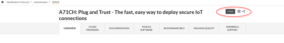

Kan_Li
Hello Roland Marx,
The next A71CH hostlib will be updated to openSSL 1.1.1, so please follow this product as below to get the notification when the new version of hostlib is available.
Hope that helps,
Kan
