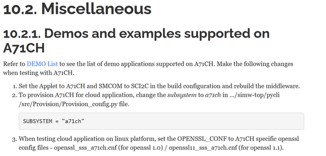

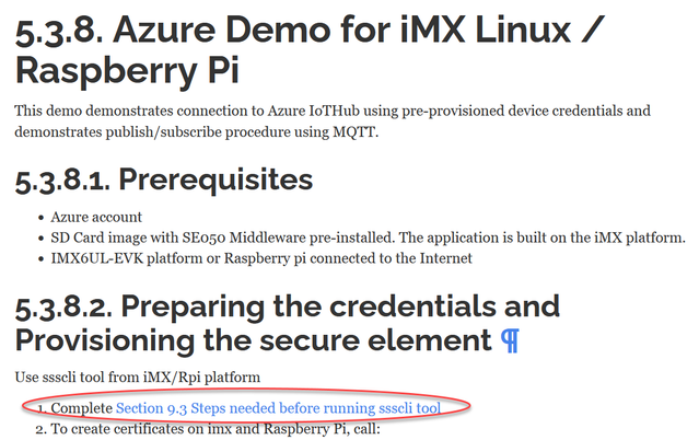

Have you followed the steps listed in the docs along with the MW?
For example,
and have you ever tried other demos such as "ex_ecc"? Did it also run into issue like this?
Kan
