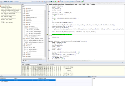

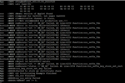

Hi Team,
i am trying to run the Qi Authentication demo. Setup is using A5000 (OM-A5000ARD) with FRDM-K64 board and using IAR Embedded Workbench.
For this i ran the Qi provisioning example to inject the keys and certificate chain as per documentation. The private key injection returned success but certificate chain failed with error code 0x6a80 which is due to policy issue i believe.
Also i tried to delete these secure objects but that fails now related to policy (looks like now read, delete objects all giving error 0x6986, for the injected key object too, which is access denied based on object policy). So i have now 4 slots injected but cannot delete these and they seem unusable due to policy settings issue.
Had tried deletion using using Delete and test provision demo as well as EX_SSS_BOOT_DO_ERASE set to 1, but they fail with error code as above. Hence request help to delete and inject the objects again for running the Qi Authenticator example.
Below is a terraterm log with EX_SSS_BOOT_DO_ERASE set, where it is now unable to delete the secure objects in the slots.
Thanking you,
Shilin

Hi @sshak ,
Actually I am guessing maybe the part on your hands is a engineering sample of A5000 so it has an older applet version. Who is the contact you request this sample from? You may ask for a released version for this test.

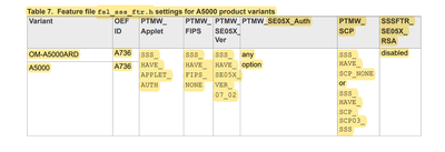

Kan_Li
Hello @sshak ,
Thanks for the information! Referring to the documentation, I can see the Qi credentials are provisioned in an AESKey session, and no delete policy assigned to the default session, so in case you want to delete the Qi credentials, you have to open the AESKey session again and delete them in this session.

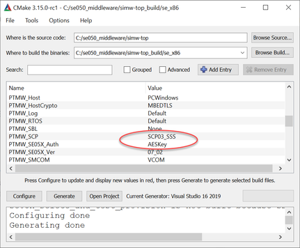

Kan_Li
Hi @sshak ,
Are you still referring to the nano-package? Actually I didn't find ex_sss_main_inc.h in that package. If you are referring to the MW instead, you may enable the Auth type as AESKey and then the  ex_sss_boot_factory_reset process may go on to erase the objects created in the AESKey session, this can be achieved as below:
For more details regarding session and policy usages, please kindly refer to the following docs from the MW:
simw-top/doc/sss/doc/apis-sss_session.html
simw-top/doc/sss/doc/apis-sss_policy.html

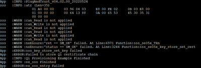

So with this the objects get deleted i believe. Then now when i run the sa_qi_provisioning demo, the ecckey seems to be provisioned but the cert chain still seems to fail. For both the key as well as cert chain though it mentions can_Read/can_Write policy is not applied (see log screenshot below). Also the certchain injection fails with error 0x6986 (SW_COMMAND_NOT_ALLOWED) in the Se05x_API_UpdateBinary_Ver call. Hence I am investigating these now.

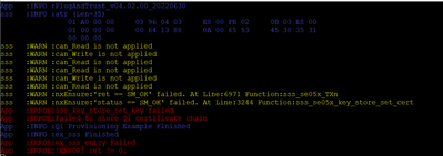

sshak
Hi Kan,
So i setup and used MCUExpresso IDE by importing project example. Had used document AN12396_EdgeLock SE05x Quick start guide with FRDM-K64F.pdf for this. To note here that this document mentions to set SSS_HAVE_SE05X_VER_07_02 in fsl_sss_ftr.h file (section 4.6 table 7) as below.
In our case setting this throws error due to applet mismatch as below .
So have now set this to SSS_HAVE_SE05X_VER_06_00 as before.
With MCUExpresso also it is unsuccessful when trying to execute sa_qi_provisioning (key provisioning seems success but cert chain provision fails with 0x6986 in the Se05x_API_UpdateBinary_ver call).
Screenshots of a debug window and terraterm log as below.
(SDK-EVK-FRDMK64F-SE-v04.02.00.zip does not have the se05x_Delete_and_test_provision nor sa_qi_provisioning examples, which are available with the SE05x_MW.zip. So took the files from there and added them to the frdmk64f_se05x_Minimal project and used now.)
Do you have any hints for it? Not sure what is issue here now. Do you maybe have a provisioning example for version 6.0.0 as A5000 does not support upgrading you mentioned?
Thanking you,
Br, shilin

sshak
hi Kan,
Thank you for this info. We have contacted the respective FAE for a newer version of this. Will go ahead once its received. Hence will close this thread.
Thank you again for your support here,
Shilin
( also jfyi that for the sake of it i had gone ahead and was able to get the provisioning to succeed as seen in log below.. by increasing the BINARY_WRITE_MAX_LEN to 750 so that the test cert chain of 720 bytes get injected in one shot though this may not be desirable

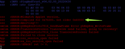

Thanks for your reply. One question here though..from the demo code, etc, it seems the R/W moved to common policies from applet version >= 7.2.0? the applet version inside our A5000 seems to indicate 6.0.0 based on the previous se05x_GetInfo demo screenshot right?
Thanking you,
Br, shilin
14,387件の閲覧回数
sshak

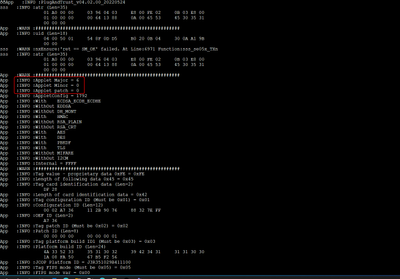

Hi Kan,
So this warning seems to come as the version i set is 060000. R/W in common policy applies from 070200. Below screen shot of code where this warning came
Also below screenshot of log when i executed se05x_GetInfo demo.
So here the A5000 applet version indicated is 060000 right? Is it possible to update this to 070200?
