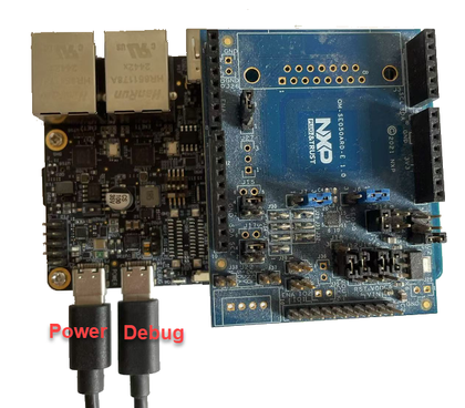

Hardware setup

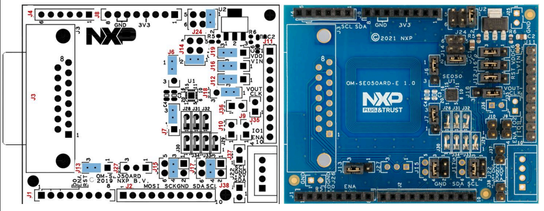

1.  Configuring the OM-SE05xARD jumpers as below[1]:
2. Confirm the boot switches on FRDM-i.MX91 to run the pre-loaded Linux® image[2].
Boot switches should be set to boot from “eMMC”.

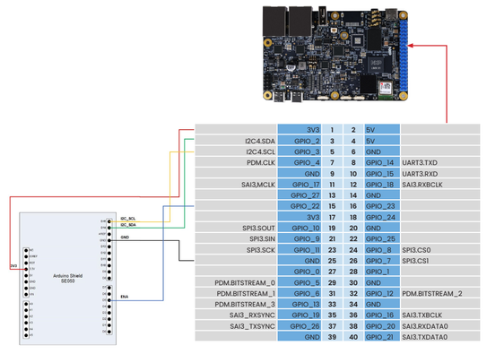

3.  Connecting SE05X with FRDM-i.MX91 as below:

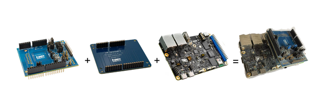

Wire connection is fine, and alternatively, you may use #OM-SE050RPI to connect them together as following.
4. Connect FRDM-i.MX91 with PC host
Connect a type C USB cable to port P16 on FRDM-i.MX91 and into the PC (as a host terminal)[2]
Connect another type C USB cable to port 1 as power supply[2].

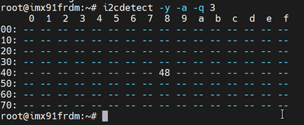

1. Enable the I2C interface
The I2C4(/dev/i2c-3) on the 40-pin expansion interface is not enabled by default , so we need to switch DTB to “imx91-11x11-frdm-8mic.dtb” in u-boot phase.
u-boot=>setenv fdtfile imx91-11x11-frdm-8mic.dtb
u-boot=>saveenv
u-boot=>reset
The following command may be used to check the connection between the host and SE then.
i2cdetect -y -a -q 3

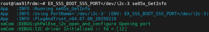

 Verify the integration with SSS examples
With above steps we may have the examples that illustrate the usage of se05x. They can be used to verify the integration as well and you may find them in build folder/bin, and if you have run "make install", some of them can also be found in /usr/local/bin so that you may execute them anywhere in the file system. but as /dev/i2c-3 is used instead of the default /dev/i2c-1, we have to set up the port accordingly before run any demo.
export EX_SSS_BOOT_SSS_PORT=/dev/i2c-3
Alternatively , we may specify the port together with the command for demo:
EX_SSS_BOOT_SSS_PORT=/dev/i2c-3 se05x_GetInfo

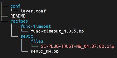

3. Add a custom Yocto layer for the Plug&Trust MW
This custom Yocto layer is part of the Plug&Trust SW distribution (simw_top/scripts/
yocto/layers/meta-custom.tgz) and must be copied and unpacked into the sources directory created above.
cp <PlugTrust>/simw_top/scripts/yocto/layers/meta-custom.tgz ~/projects/imx-yocto-bsp/sources
cd ~/projects/imx-yocto-bsp/sources
tar xzvf meta-custom.tgz
Put the se05x recipe(se05x_mw.bb) and the source code package (for example, SE050-PLUG-TRUST-MW-v04.07.00.zip) into the existing .../sources/meta-custom/recipes directory of the Yocto development PC.
The resulting imx-yocto-bsp/sources/meta-custom directory on the Yocto development PC should look like:
Update the conf/bblayers.conf and conf/local.conf within the build folder accordingly .
  • How to have the updated se05x_mw.bb, local.conf and bblayers.conf
unzip the source code package and go to the folder of "SE-PLUG-TRUST-MW_04.07.00\simw-top\scripts\yocto\bitbake_script_and_conf_files". Then apply the attached patch in this folder with the git command:
$ git apply bitbake_script_and_conf_files.patch

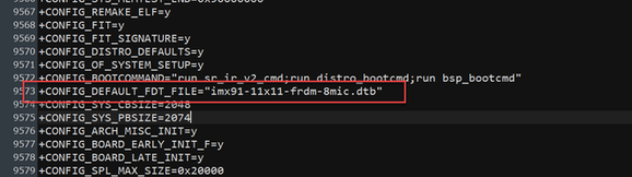

5. To switch the DTB to “imx91-11x11-frdm-8mic.dtb” which enables "/dev/i2c-3", update the patch file of "0003-imx-imx91_frdm-Add-basic-board-support.patch" in the following path("~projects/imx-yocto-bsp/sources/meta-imx-frdm/meta-imx-bsp/recipes-bsp/u-boot/u-boot-imx/")
