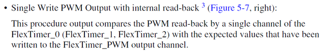

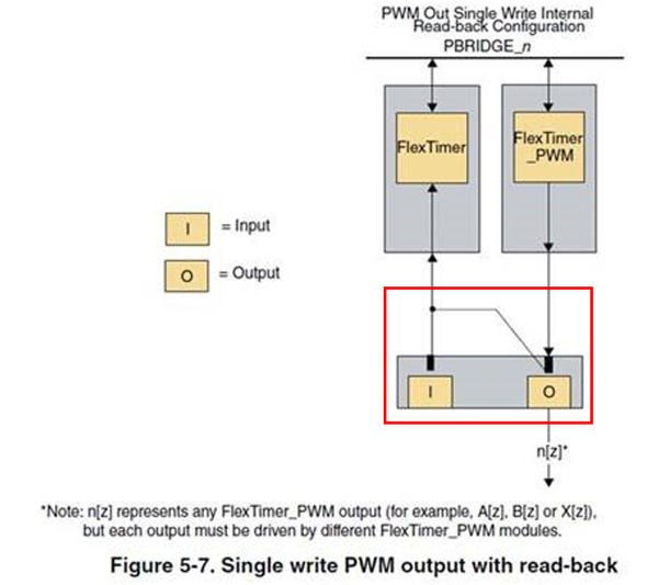

Hello Team,
The S32K1xx Safety Manual shows Single write PWM output with read-back.
How is it possible to obtain the internal signal path highlighted in red?
How is the "Single Write PWM Output with internal read-back" practically implemented?
Can you please elaborate?
Thank you,
BR, Daniel

Hi Daniel,
Thanks for pointing out. This is a known issue with S32K1xx Safety Manual and actions are being initiated to address it.
In fact the internal read-back path DOES NOT exists in FTM. With the next release of SM (due in couple of days), it will be corrected.
NaveenM
