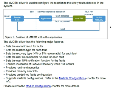

HeebeomPark
Which Fault can be recoverable?
How can be the the recovered Fault identified ?
We don't know how can we configure it.
