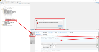

      There is requirement from customer that generate FMEDA based SN29500, mission profile is passenger compartment and achieve ASIL-D. I have download the medini project(S32K344.CUT_1_0.RELEASE.2021_R2.002-172pins) from sharepoint and open it in medini(analyze 2021 R2.1) ,switch the license to Premium. I swith the standard in catalog, but the error rised as the follow and the failure rate is NAN.
so I have the question about switching to SN29500, could you pls give me some suggestions about it? thank you!

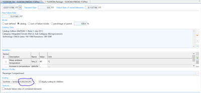

As we discussed over call that in SN29500 norms we need to multiply the lambda with a percentage of our fit, in scaling factor to calculate the fit. I hope that now your doubts are clear so, am requesting you to close this issue and for your future reference am posting here some snapshots also.
