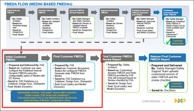

Hi Marcelo,
For customers only static FMEDA is published. Since customer is asking for re-configuration of FMEDA to support their use-case. The action is on FAE community to support (shown in the red box below).
Let me know if there are any questions.
