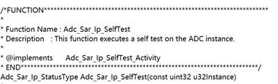

ADC Self Test :
The ADC driver implements self-test features in the functions Adc_SelfTest (HLD) and Adc_Sar_Ip_SelfTest (IPL). Please check those APIs.
Self-Test period :
The recommendation is to run ADC supply and capacitive self-tests at start-up, before executing the safety function.

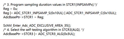

hello, I have a problom about ADC with the configuration listed below:
* Project : RTD AUTOSAR 4.4
* Platform : CORTEXM
* Peripheral : ADC_SAR
* Dependencies : none
* Autosar Version : 4.4.0
* Autosar Revision : ASR_REL_4_4_REV_0000
* Autosar Conf.Variant :
* SW Version : 3.0.0
* Build Version : S32_RTD_3_0_0_D2112_ASR_REL_4_4_REV_0000_20211221

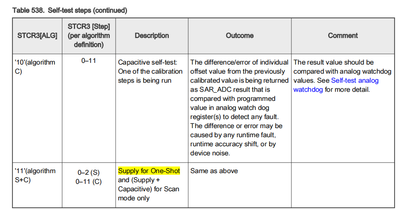

S32G2,MCAL,normal conversion, one shot operation mode , STCR3[ALG]=0x3(
function name:Adc_Sar_lp_SelfTest
According to table 538,in one-shot mode,supply algorithm will be excuted only.
question:
1.Does the function(Adc_Sar_lp_SelfTest) just test Supply Algorithm(S0,S1,S2) while not excuting the test of Capacitive Algotirthm?
2.Do NXP supply the function whice support both(Supply+Capacitive Algorithm) for one-shot mode?

Please find the answers to you question below:
Q1.Does the function(Adc_Sar_lp_SelfTest) just test Supply Algorithm(S0,S1,S2) while not executing the test of Capacitive Algorithm?
Ans: No, the Adc_Sar_lp_SelfTest runs the "algorithm Supply+Capacitive".
Q2.Do NXP supply the function whice support both(Supply+Capacitive Algorithm) for one-shot mode?
Ans: As mentioned above the Adc_Sar_lp_SelfTest supports both (Supply+Capacitive) algorithm.

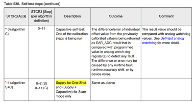

according to the table below: when ADC works in one shot mode,only the supply algorithm will be applied.
however we can meet the requirement of ASIL C without the safety measure of C algorithm.
thanks for your apply.
