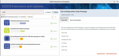

Hello @chenyin_h,
Thank you for your response.
I have downloaded the exact RTD package you mentioned:
I am using S32 Design Studio 3.6.6 on Linux.
Steps I followed:
  1. Opened S32DS 3.6.6
  2. Went to Help → S32DS Extensions and Updates
  3. Clicked Add Update Site
  4. Selected the above RTD ZIP file
After adding the update site successfully, I do not see “Real Time Drivers (RTD)” explicitly listed in the available software list.
Karthik

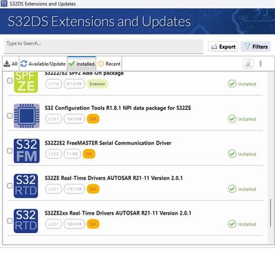

chenyin_h
Hello, @karthik_nikil
Thanks for your reply.
I tried testing it on my side and sorry that I did not reproduce the issue.
Below is my installed list for installing the RTD, shared for your reference.
You may try uninstalling the S32E/Z configuration tools first and then try installing the RTD.
Chenyin

karthik_nikil
Hello @chenyin_h ,
Thank you for your guidance earlier.
I would like to share some additional details and ask for your help on a few points.

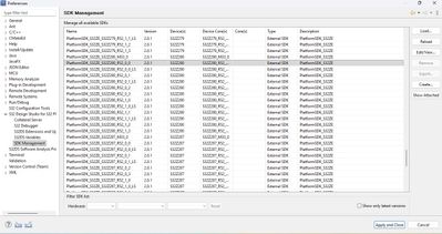

I have successfully installed the S32Z2E Real-Time Drivers (RTD).
Initially, I tried installing and working with Linux, but I was not able to proceed further. After switching to Windows, the RTD installation completed successfully.
However, I am now facing another issue on Windows:
  • After installing the S32Z2E RTD, when I try to create a new project in S32 Design Studio
  • I select the board S32Z280
  • On the SDK selection page, I am unable to see the PlatformSDK for S32Z2E
  • At the same time, in the SDK Manager, the S32Z2E SDK appears to be installed correctly
Because of this, I am not able to proceed with project creation.
Could you please help me.
Your support would be greatly appreciated.
Karthik

chenyin_h
I suggest trying the following way:
Since the RTD of S32Z is developed and tested under GCC10.2, to change it to the corresponding version and then the SDK could be selected.
Chenyin
1,516件の閲覧回数
karthik_nikil
Hello @chenyin_h ,
Thank you for your support.
The SDK is now visible in the project creation page, and I am able to see the required PlatformSDK file.
Karthik
