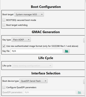

  2. Created an IVT image using the S32 IVT Tool
    • Selected the LED example application (which works when debugged via Lauterbach).
    • This is the configuration:
  • After configuration, I pressed the "Export Image" button in the Application Bootloader section to update the image blob.

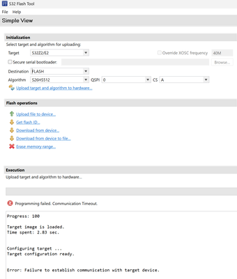

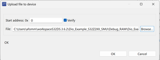

  1. Flashing the image
    • In the IVT tool, I clicked "Flash Image" and selected the S26HS512.bin algorithm for HyperFlash.
    • Issue: The flashing process is inconsistent. Sometimes it succeeds, but often it fails.

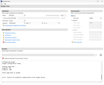

    • When it fails, I get this error:
    • I noticed slightly better results after disconnecting the Lauterbach JTAG adapter

I have also tried to flash to the QSPI Flash by connecting to the J119 USB with this configuration:
RCON switches:
J1245 and J125 in serial mode:
I got the same error with the Flash Tool:

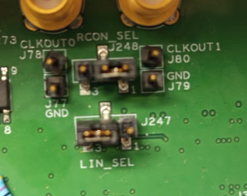

alejandro_e
Hello @raz3l,

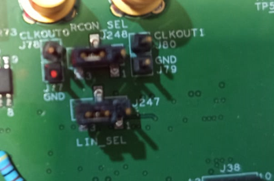

I must have gotten my images mixed up. Keep RCON, JP3,  J124 and J125 as they are, just change the following to boot:
To boot:
J248 3-2
J247 3-2
I tested with the previous binary and the new one, both blink D12 as expected.
Sorry for the confusion,
please let me know if you are now able to boot your program correctly.

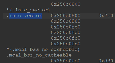

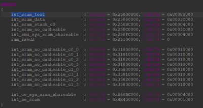

Disable the following check:
Ensure that the RAM start address matches int_sram_text in the linker_ram_m33.ld and that RAM entry pointer matches the intc_vect address in the Siul2_Dio_Ip_Example_S32Z2XX_SMU_2.map file, these may vary depending on your project configuration.

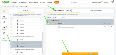

If you keep having problems you can get the GreenVIP package in the AUTO-SW-PACKAGE-MANAGER
It includes flashing scripts for the Lauterbach debug.
Let me know if you need more help.

1. Creating the IVT. My configuration:
RAM Start pointer:
RAM Entry pointer:
I pressed "Exported Image" and "Align" after filling the data.

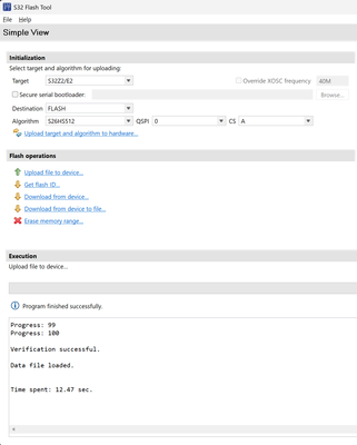

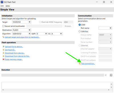

2. Flashing the board. Configuration and steps:
Pressed "Test Connection" and then uploaded algorithm with success.
Then, download the app to the hyperflash:
3. Power cycling the board and changing RCON switches and J125/125 to boot from hyperflash.
RCON:
However, I keep not seeing D12 LED blinking with this method. Could the size of the application be a issue? Or what could be wrong?

raz3l
Hi @alejandro_e ,
I just tried flashing the board using the provided flash algorithm binary. The flashing process completes successfully, but the issue persists.
I dumped the flash memory using the Flash Tool and compared it with the application binary (attached). There are no differences, so it seems the application was correctly downloaded.

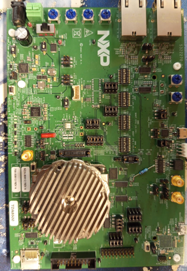

alejandro_e
Hello @raz3l,

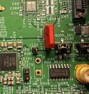

Thanks for all the info, I was able to perform all the tests I needed and I was able to find the root cause of the problem, it was not the binary, it is the board jumper configuration, please check the following to boot from QSPI (you should already have some of this configured correctly):
J124 and J125:
RCON:
J247 and J248
JP3 (the only JPx selected)
Any deviation from this configuration will cause problems.
This is a photo of the complete board so you can copy the configuration of any other jumper if needed:
I would recommend you to request access to the S32Z2 secure files and the GreenVIP software package, which I mentioned earlier, since you will find them very useful during the development of your project.
Please let me know if this information solved your problem.
Thanks!

raz3l
Hi @alejandro_e ,
Unfortunately, it still didn’t do the trick.
Could you try flashing the binary of the app I’m attempting to flash? I’ve attached it to this message.
Below is the configuration I used to set up the board after successfully flashing it using the GreenVIP flash algorithm. It seems to match yours, right? Despite the jumpers of J37 which I has using for a secondary UART. Neverthless, I placed the jumpers on that pins and it didn't work
3,098 Views
alejandro_e
Hello @raz3l,
To boot:
J248 3-2
J247 3-2
3,084 Views
raz3l
Awesome! It's working @alejandro_e .

raz3l
Yes, I'm in the process to have access to the secure files. I have also installed the GreenVIP software package to get the flash algorithm as you mentioned.
