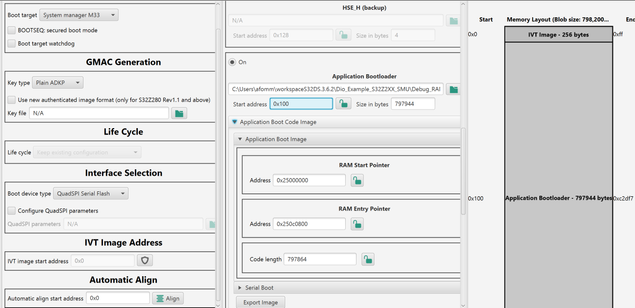

  2. Created an IVT image using the S32 IVT Tool
    • Selected the LED example application (which works when debugged via Lauterbach).
    • This is the configuration:
  • After configuration, I pressed the "Export Image" button in the Application Bootloader section to update the image blob.

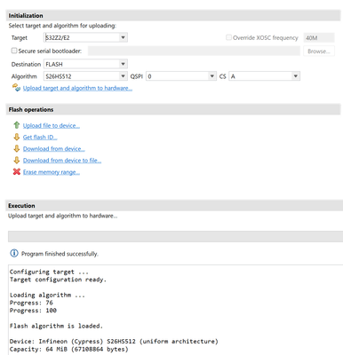

  1. Flashing the image
    • In the IVT tool, I clicked "Flash Image" and selected the S26HS512.bin algorithm for HyperFlash.
    • Issue: The flashing process is inconsistent. Sometimes it succeeds, but often it fails.
    • When it fails, I get this error:

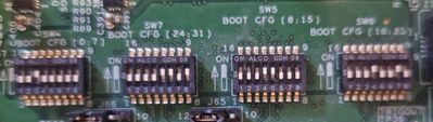

  2. Board boot configuration
    • After (successful) flashing, I changed the RCON switches to 0x70481804, which I copied from the HyperFlash Lauterbach script.
    • I then power-cycle the board.

And for RCON, use the following configuration:
This is to boot from the S22HM576 HyperFlash.

1. Creating the IVT. My configuration:
RAM Start pointer:
RAM Entry pointer:
I pressed "Exported Image" and "Align" after filling the data.
2. Flashing the board. Configuration and steps:
Pressed "Test Connection" and then uploaded algorithm with success.
Then, download the app to the hyperflash:

Thanks for all the info, I was able to perform all the tests I needed and I was able to find the root cause of the problem, it was not the binary, it is the board jumper configuration, please check the following to boot from QSPI (you should already have some of this configured correctly):
J124 and J125:
RCON:
J247 and J248
JP3 (the only JPx selected)
Any deviation from this configuration will cause problems.
This is a photo of the complete board so you can copy the configuration of any other jumper if needed:

Below is the configuration I used to set up the board after successfully flashing it using the GreenVIP flash algorithm. It seems to match yours, right? Despite the jumpers of J37 which I has using for a secondary UART. Neverthless, I placed the jumpers on that pins and it didn't work
4,093 Views
alejandro_e
Hello @raz3l,
I must have gotten my images mixed up. Keep RCON, JP3,  J124 and J125 as they are, just change the following to boot:
To boot:
J248 3-2
J247 3-2
I tested with the previous binary and the new one, both blink D12 as expected.
Sorry for the confusion,
please let me know if you are now able to boot your program correctly.
4,079 Views
