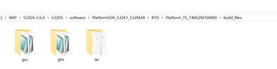

         We are working on an ASIL B project using the S32M244 chip. Currently, our project IDE is S32DS, but it seems that it has not yet obtained functional safety certification. Our company has already purchased Keil MDK (a tool certified for functional safety), but we cannot find any pack packages for the S32M244 that would allow us to compile and develop using Keil.
And form the RTD seems it not support Keil too.
Q:  How we can use Keil for the development of S32M244 functional safety projects? If cannot support it, which IDE should we choose for developing the S32M244 functional safety projects?

S32DS is just development studio/ eclipse based. The issue is gcc compiler which is not safety certified.
You can use NXP drivers which supports IAR and GHS which are safety certified, and can be integrated into S32DS.

For S32M244 functional‑safety development, Keil MDK cannot currently be used, because no Keil CMSIS‑Pack exists for S32M244 and the S32M2 RTD does not support Keil.
NXP’s functional‑safety software packages — SAF (Safety Software Framework) and SPD (Safety Peripheral Drivers) — are officially provided only for S32 Design Studio (S32DS) and include installable packages and example project templates directly for that IDE.
Therefore, the recommended and supported IDE for S32M244 functional‑safety projects is:
S32 Design Studio + NXP SAF/SPD safety packages
These components are designed to support ISO 26262 development on S32M2 devices, even though the IDE itself is not TÜV‑certified.
