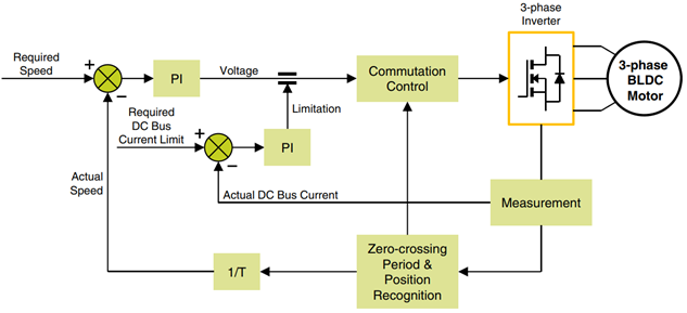

3.4.5. Run
The block diagram of the run state is represented by Figure 1. The motor speed is estimated based on Hall events. The difference between the demanded and estimated speeds is fed into the speed PI controller. The output of the speed PI controller is proportional to the voltage to be applied to the BLDC motor. The motor current is measured and filtered and used as feedback into the current controller. The output of the current PI controller limits the output of the speed PI controller. The limitation of the speed PI controller output protects the motor current from exceeding the maximal allowed motor current.
 Figure 1. Speed control with current limitation

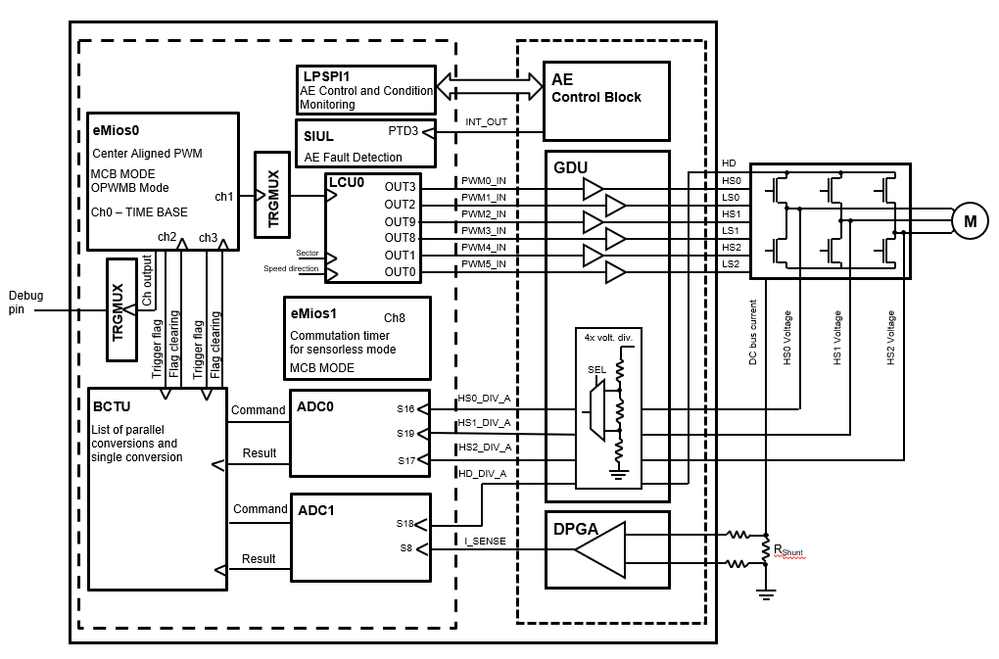

4.1. S32M276 – Key modules for BLDC 6-step control
The S32M276 is an integrated solution which comprises MCU and Application Extension part (AE). The AE includes modules such as Gate Driver Unit (GDU) and Digital Programmable Gain Amplifier (DPGA) which allow for using S32M276 in motor control applications with minimum of external components. The MCU part includes modules such as the Enhanced Modular IO Subsystem (eMIOS), Logic Control Unit (LCU), Trigger
MUX (TRGMUX), Body Cross-triggering Unit (BCTU) and Analogue-to-Digital Converter (ADC) suitable for real-time control applications, in particular, motor control applications. These modules are directly interconnected and can be configured to meet various motor control application requirements. Figure 2 shows a module
interconnection for a typical BLDC 6-step application working in sensorless mode using single shunt current sensing. The modules are described in further chapters and the detailed description can be found in the S32M27x Series Reference Manual (see section References).
jump to top
4.1.1. Module interconnection
As mentioned earlier, S32M27x consists of two parts: MCU and AE which are connected together via die-to-die (D2D) connections.
The SPI interface (part of D2D) serves for parameter settings and status monitoring of AE and the rest of D2D interface is used for motor control loop (e.g.: DC bus current reading).
The AE comprises modules vital for motor control such as Gate Driver Unit (GDU) and Digital Programmable Gain Amplifier (DPGA) which allow for using S32M276 in motor control applications with minimum of external components.
The GDU drives the power MOSFETs. The GDU is interconnected with the outputs of FTM via D2D connections.
The shunt resistor voltage drop signal (proportional to DC Bus current) is conditioned by the integrated DPGA which output is connected to the ADC via D2D connection.
DC Bus voltage and BEMF voltages are conditioned via integrated voltage dividers which outputs are connected to the ADC via D2D connection.
The MCU modules involved in output actuation, data acquisition and synchronization of actuation and acquisition are called Control Loop. This control loop consists of the eMIOS, LCU, TRGMUX, BCTU and ADC modules. The control loop is a modular concept and is very flexible in operation and can support static, dynamic or asynchronous timing. eMIOS plays a role of the real time timer/counter. Within the control loop it is responsible for generation of basic PWM signal (period, duty cycle), generation of the trigger for analogue data capturing in the precise moment or measuring the time between events. LCU enriches this modular concept with advance features. In PWM generation it is responsible for creation of PWM complementary pairs, dead time insertion, execution of a commutation table (role of the phases based on the commutation sector) and disabling/enabling PWM outputs. BCTU and ADC modules are responsible for analog data capturing. BCTU answers question “what is going to be measured?” by a predefined list of ADC channels. The ADC answers question “How it is going to be measured?” by setting a conversion resolution, sampling duration etc.
eMIOS timer uses the concept of time-bases for signal synchronization. There are 5 channels (CH0, CH8, CH16, CH22 and CH23) which can act as the time-base what means that other channels can see value of their counter through the bus. CH0, CH8, CH16 can create local time-bases for 7 following channels and CH22 and CH23 can create a global time-bases for any channel. In the example eMIOS0 is used for PWM and triggers. CH1 is responsible for PWM. CH2, CH3 are responsible for triggering of the BCTU. CH2 triggers parallel measurement of DC-bus voltage and BEMF voltage of disconnected phase and CH3 triggers the DC-bus current sample.
eMIOS0 and LCU are connected through TRGMUX unit which is responsible for a configurable signal interconnection within the microcontroller. The eMIOS0 channel CH1 creates basic PWM signal, and it is formed using flexible Output Pulse Width Modulation Buffered (OPWMB) eMIOS mode where two compare registers (A, B) are used to control rising and falling edge independently. LCU OUT0-OUT3, OUT8-OUT9 create complementary PWM pairs to control MOSFET transistors. Besides PWM signal, there are direction and sector inputs controlled by SW override feature. The LCU uses look-up tables, output polarity control to perform commutation and to create complementary PWM pattern for active phase. Configurable digital filters are used to insert deadtime to the final complementary signals for transistors. Same as in PWM signal generation, OPWMB mode is used for generation of trigger signals. Channels are linked with PWM time base CH0. Time base CH0 operates in Modulus Counter Buffered (MCB) up counting mode, where period is set by register A.
Two eMIOS trigger channels are connected internally to BCTU (input channels BCTU_EMIOS_0_2 and BCTU_EMIOS_0_3) through eMIOS channel flag. In this example flag is generated on compare with register B. BCTU handles flag clearing. BCTU is capable of controlling all three ADCs, so list of single or parallel conversions can be invoked. In this example BCTU_EMIOS_0_3 triggers single conversion of ADC1 (channel S8) to obtain DC-link current. BCTU_EMIOS_0_2 triggers list of parallel of conversion ADC1 (channel S18 for DC-bus voltage) and ADC0 (channel S16/S17/S19 for BEMF voltage of disconnected phase). The result can be stored into BCTU result register, BCTU FIFO and they are also visible in original ADC result registers or can be transferred by DMA.
eMIOS1 CH8 is used as a timer to measure zero-cross time and to set commutation event. CH8 operates in MCB mode where actual value of the counter can be read, and it's compared with register A defines the event for commutation.
Detailed description of the respective modules can be found in the S32M27x Series Reference Manual (see section References).
   Figure 2. S32M276 modules interconnection.

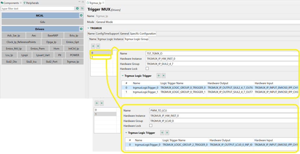

4.2.5. TRGMUX
 TRGMUX is responsible for interconnection of microcontroller internal signals. Hardware Group defines group of TRGMUX outputs (from TRGMUX to peripheral). Hardware Output defines the output from TRGMUX to peripheral, and Hardware Input defines input from peripheral to TRGMUX. All possibilities for TRGMUX connection can be found in S32M27x reference manual, see References.
Hint: Pins with TRGMUX out functionality are useful for debugging/visualization of internal signals.
     Figure 7. TRGMUX configuration for PWM and test/debug signals.

Figure 16 presents the conceptual system block diagram of the BLDC Six-step control technique working in sensorless mode.
The application is optimized for S32M276 motor control peripherals to achieve the least possible core involvement in state variable acquisition and output action application. The motor control peripherals (ADC, BCTU, eMIOS, LCU) are internally linked together to work independently from the core, and to achieve deterministic sampling of analog quantities and precise commutation of the stator field. The software part of the application consists of different blocks which are described below. The entire application behavior is controlled from a PC through the FreeMASTER run-time debugging tool.
The inputs of the control loop are the measured voltages and current on the power stage: the DC bus current, DC bus voltage and BEMF voltages.
From a control perspective, the block diagram can be divided into two logical parts:
  • Commutation control, where the phase voltages and DC bus voltage are used to calculate the actual position of the shaft. According to the identified position, the next commutation event can be prepared.
  • Speed/torque control, where the required shaft velocity is compared to the actual measured speed and regulated by the PI controller. The output of the speed PI controller is the duty cycle. The duty cycle is limited by the current PI controller and assigned to the PWM.
Figure 16. System block diagram.

4.3.5. Speed evaluation, motor current limitation and control
The speed controller is executed in a timer interrupt every 1 ms. The actual speed is calculated from all of the last six commutation periods, and this is stored as the actual speed. The required speed is fed into the ramp function controlling the motor speed slope. The difference between the speed ramp function output and actual speed defines the speed error.
In the closed-loop mode, the actual speed error is fed into the PI controller function. Inputs to the PI controller function include the speed error and the PI controller’s parameters such as the proportional and integral gain constants. The output of the PI controller is the duty cycle, which is scaled to the PWM resolution.
At the end of the speed control function, the duty cycle is loaded into the eMIOS compare registers of eMIOS0_CH1.
The current limit controller is located in the same 1 ms timer interrupt (.../src/main.c/Pit1Notif() ) as the speed controller because the inputs and outputs of both controllers are linked together.
When the actual speed has been calculated, the current limit PI controller can be called by feeding it with the difference between the actual current and the maximum allowed current of the motor. The output of the PI controller is scaled to the number proportional to the PWM period. After the current PI controller has calculated its duty cycle, both duty cycle output values are compared to each other.
If the speed PI controller duty cycle output is higher than the current limit PI controller output, then the speed PI Controller duty cycle output value is limited to the output value of the current limit PI controller. Otherwise, the speed PI duty cycle output will be taken as the duty cycle update value. At the end, the integral portion values of both the PI controllers need to be synchronized to avoid one of the controllers increasing its internal value as far as the upper limit. If the duty cycle was limited to the current PI duty cycle output, then the integral portion of the current PI controller will be copied into the integral portion of the speed controller, and vice versa.
