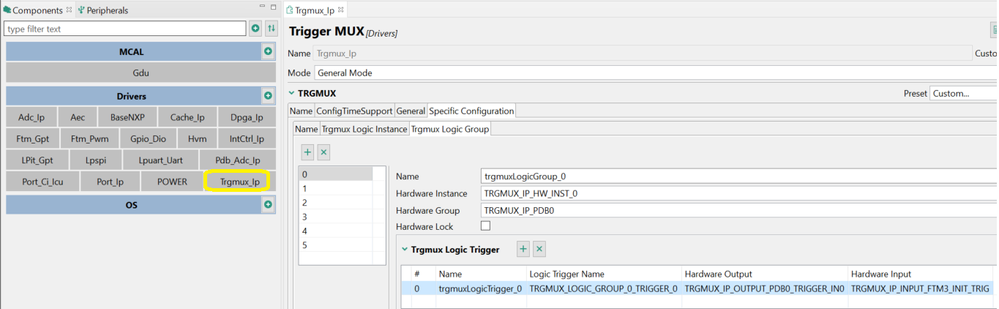

4.2.3. Trigger MUX Control (TRGMUX)

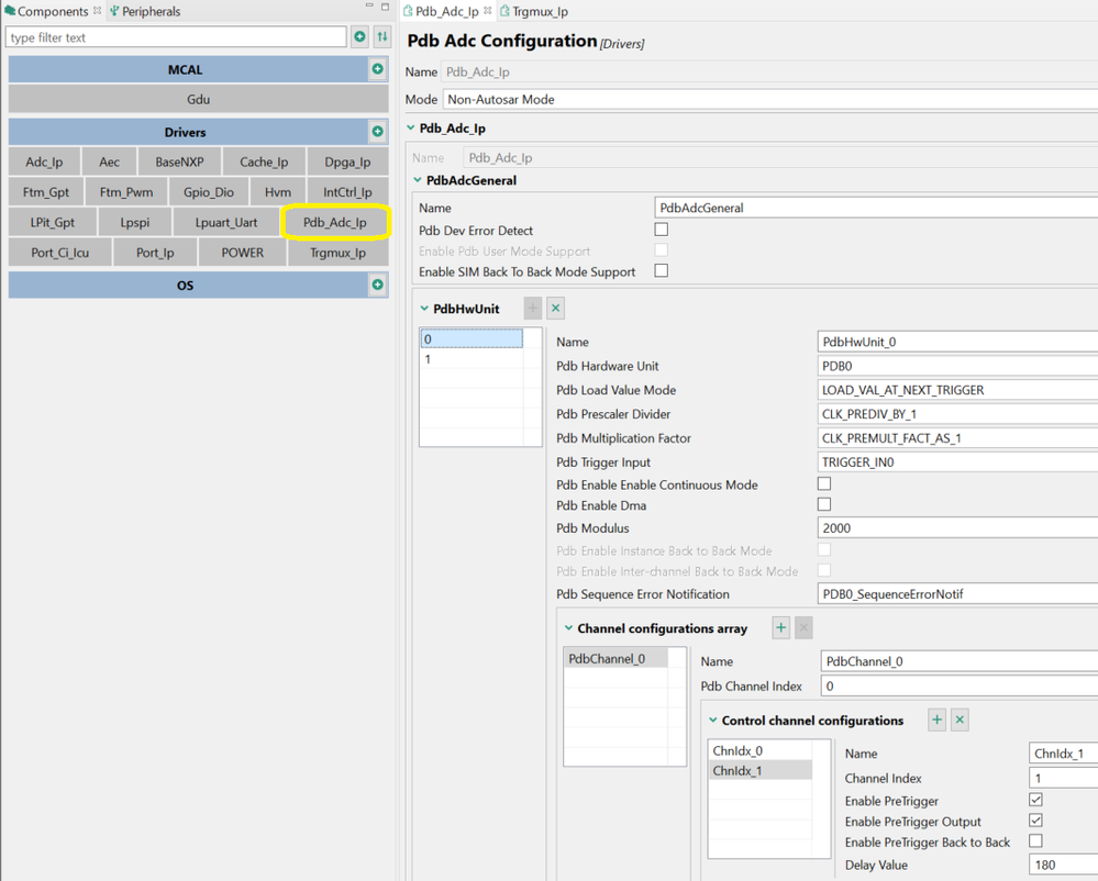

4.2.4. Programmable delay block (PDB)

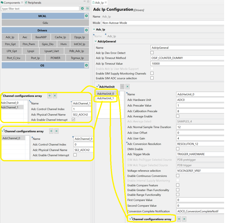

4.2.5. Analog-to-digital converter (ADC)

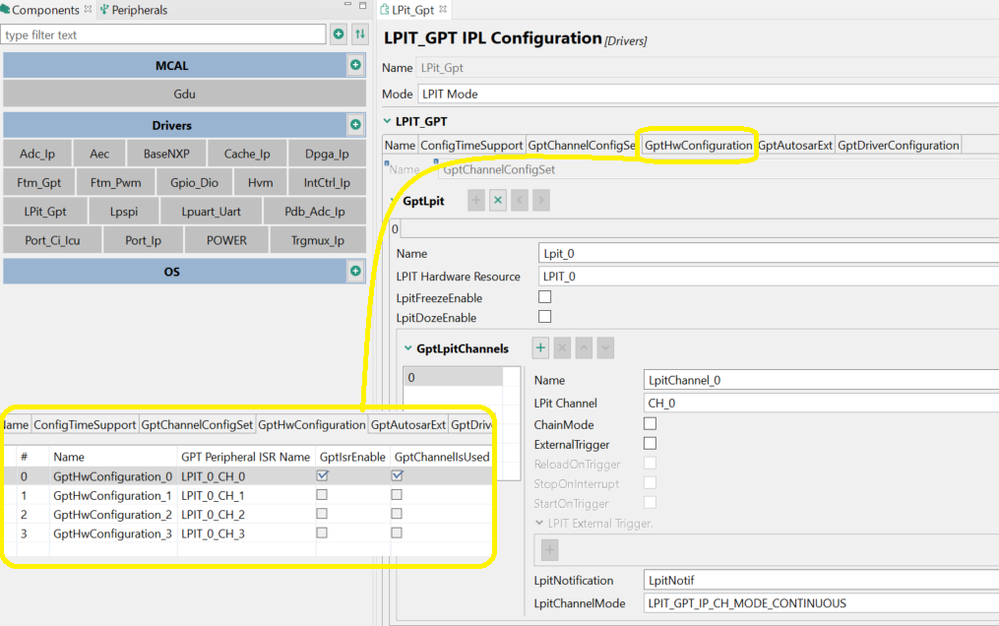

4.2.10. Low Power Interrupt Timer (LPIT) configuration

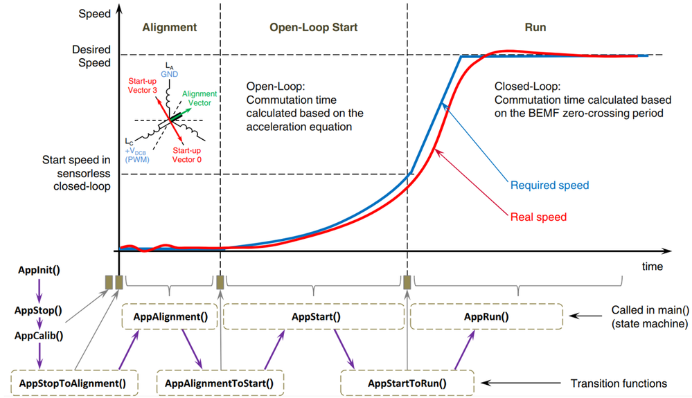

In order to start and run the BLDC motor, the control algorithm has to go through the following states:
  • Initialization
  • Calibration
  • Alignment (initial position setting)
  • Start-up (forced commutation or open-loop mode)
  • Run (sensorless running with BEMF acquisition and zero-crossing detection
3.4.1. Initialization
Initialization of variables relevant for motor control.
3.4.2. Calibration
In this state the DC current measurement calibration takes place.
3.4.3. Alignment
As mentioned previously, the main task for sensorless control of a BLDC motor is position estimation. Before starting the motor, however, the rotor position is not known. The aim of the alignment state is to align the rotor to a known position. This known position enables starting the rotation of the shaft in the desired direction and generating the maximal torque during start-up. During the alignment state, all three phases are powered in order to get the best performance behavior in either direction of shaft rotation. Phase C is connected to the positive DC bus voltage and phases A and B are grounded. The alignment time depends on the mechanical constant of the motor, including load, and also on the applied motor current.
3.4.4. Start-up
In the start-up state, motor commutation is controlled in an open-loop mode without any rotor position feedback. The commutation period is controlled by an open-loop starting curve. The open-loop start is required only until the shaft speed is high enough (approximately 5% of nominal motor speed) to produce an identifiable BEMF voltage.
3.4.5. Run

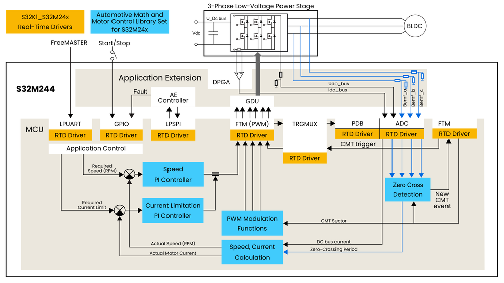

The block diagram of the run state is represented by Figure 1 and includes the BEMF acquisition with zero-crossing detection in order to control the commutations. The motor speed is estimated based on zero-crossing time periods. The difference between the demanded and estimated speeds is fed into the speed PI controller. The output of the speed PI controller is proportional to the voltage to be applied to the BLDC motor. The motor current is measured and filtered during the BEMF zero-crossing event and used as feedback into the current controller. The output of the current PI controller limits the output of the speed PI controller. The limitation of the speed PI controller output protects the motor current from exceeding the maximal allowed motor current.
 Figure 1. Speed control with current limitation
jump to top
4. Software implementation on S32M244 
4.1. S32M244 – Key modules for BLDC 6-step control
The S32M244 is an integrated solution which comprises MCU and Application Extension (AE).  The MCU part includes modules such as the FlexTimer Module (FTM), Trigger MUX Control (TRGMUX), Programmable Delay Block (PDB) and Analog-to-Digital Converter (ADC) suitable for control applications, in particular, motor control applications. These modules are directly interconnected and can be configured to meet various motor control application requirements. Figure 2 shows module interconnection for a typical BLDC 6-step application working in Sensorless mode using single shunt current sensing. The modules are described in further chapters and the detailed description can be found in the S32M24x Series Reference Manual (see section References).
jump to top

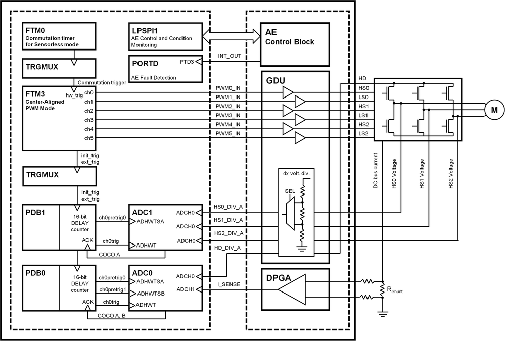

4.1.1. Modules interconnection
As mentioned earlier, S32M24x consists of two parts: MCU and AE which are connected together via die-to-die (D2D) connections.

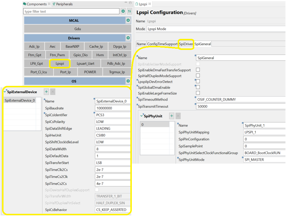

The SPI interface (part of D2D) serves for parameter settings and status monitoring of AE and the rest of D2D interface is used for motor control loop (e.g.: DC bus current reading).
The AE comprises modules vital for motor control such as Gate Driver Unit (GDU) and Digital Programmable Gain Amplifier (DPGA) which allow for using S32M244 in motor control applications with minimum of external components.
The GDU drives the power MOSFETs. The GDU is interconnected with the outputs of FTM via D2D connections.
The shunt resistor voltage drop signal (proportional to DC Bus current) is conditioned by the integrated DPGA which output is connected to the ADC via D2D connection.
DC Bus voltage and BEMF voltages are conditioned via integrated voltage dividers which outputs are connected to the ADC via D2D connection.
The MCU die modules involved in output actuation, data acquisition and the synchronization of actuation and acquisition, form the so-called Control Loop. This control loop consists of the FTM, TRGMUX, PDB, and ADC modules. The control loop is very flexible in operation and can support static, dynamic or asynchronous timing.

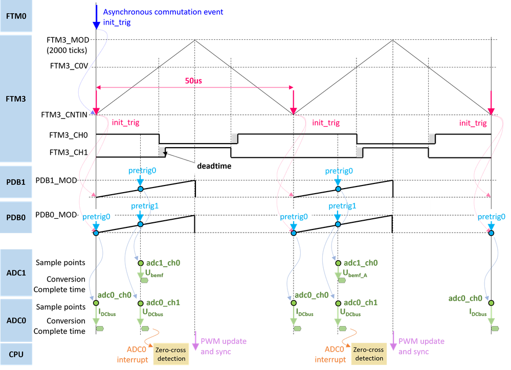

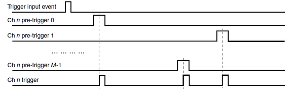

Each control loop cycle can be initiated either by FTM initialization trigger init_trig or by FTM external trigger ext_trig. While init_trig signal is generated at beginning of PWM cycle, ext_trig can be generated any time within the PWM period based on the value defined in the corresponding FTM Channel Value register CnV.
FTM trigger signal is routed to hardware trigger input of the PDB module through flexible TRGMUX unit. In S32M24x, there are two ADC modules and two PDB modules that work in pairs. This means that PDB0 is linked with ADC0 and PDB1 is linked with ADC1.
PDB pre-triggers ch0pretrigx are used as a precondition for ADC module. They are directly connected to ADHWTS ports to select ADC channels as well as order of the channels by configurable pre-triggers delays. When ADC receives rising edge of the trigger, ADC will start conversion according to the order defined by pre-triggers ch0pretrigx.
PDB pre-trigger delays must be properly set to allow reliable operation between PDB and corresponding ADC module. When the first pre-trigger is asserted, associated lock of the pre-trigger becomes active until corresponding conversion is not completed. This associated lock is released by corresponding ADC conversion complete flag ADC_SC1[COCOx]. This means that next pre-trigger can be generated only if the ongoing conversion is completed.
FTM0 module is used for commutation control. It is configured to schedule and force commutation events which are determined from the actual BEMF zero-crossing period.
Detailed description can be found in the S32M24x Series Reference Manual (see section References).
  Figure 2. S32M244 modules interconnection.

4.1.2. Modules involvement in digital BLDC control loop
This section will discuss timing and modules synchronization to accomplish BLDC 6-step control on the S32M244 and the internal hardware features.
The timing diagram of the automatic synchronization between PWM and ADC in the BLDC application is shown in Figure 3.Figure3.png
Figure3. Time Diagram of PWM and ADC Synchronization.

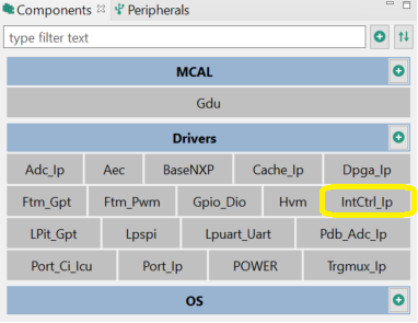

4.2.1. Clock configuration and power management
S32M244 features a complex clocking sourcing, distribution and power management. To run a core of the S32M244 as well as some MCU peripherals at maximum frequency 80 MHz in normal RUN mode, S32M244 is supplied externally by 16 MHz crystal. This clock source supplies Phase-lock-loop (PLL), which circuit multiplies frequency by 20 and divides by 2 resulting 160 MHz frequency on output. PLL output is then divided by 2 to supply core and system (80 MHz), further divided by two and four to supply bus clock (40 MHz) and flash clock (20 MHz), respectively. This clock configuration belongs to one of the typical and recommended. It is summarized in Table 2.
Table 2. S32M244 clock configuration in RUN mode.
Clock Frequency
CORE_CLOCK 80 MHz
SYS_CLK 80 MHz
BUS_CLK 40 MHz
FLASH_CLK 20 MHz (max frequency in RUN mode)
This clock configuration can be setup by S32 CT Clocks graphical tool, for further details see the SW example, where the detailed clock settings for the particular peripherals can be found.
Once the clock configuration is set, RTD generates static configuration structure Clock_Ip_aClockConfig[0], the respective RTD API is then called in MCUClockConfig which can be found in the SW example in .../src/Peripherals/peripherals_config.c.
As discussed at the beginning of this chapter, power management of the S32M244 is configured for normal RUN mode. This power mode can be set in S32CT Peripherals graphical tool, Figure 4.
Figure 4. S32M244 power management configuration in S32CT Peripherals tool.

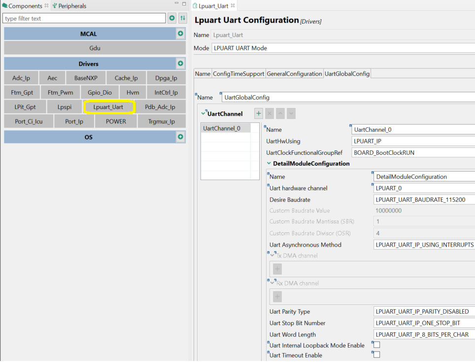

Static configuration generated by RTD is called by the respective RTD API and this is encapsulated in MCUPowerConfig function, which can be found in the SW example in .../src/Peripherals/peripherals_config.c
The same mechanism for peripherals configuration by RTD works for all S32M244 peripherals, which are discussed below.

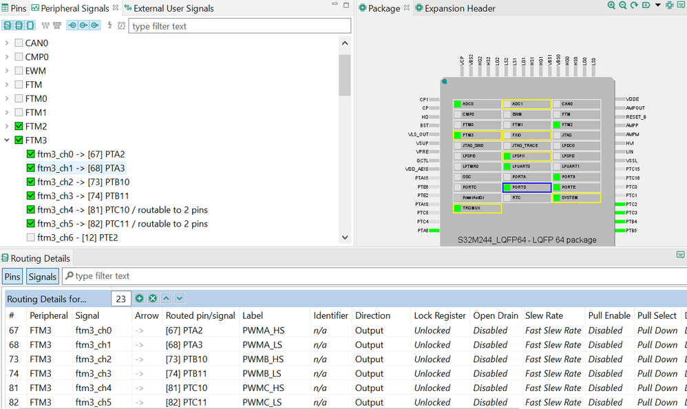

4.2.2.1. Center-aligned PWM mode
FTM3 instance is used in BLDC 6-Step motor control application to generate center-aligned PWM by three complementary channels pairs to control power MOSFETs.
The configuration is shown in Figure 5, FTM3 PWM frequency of 20 kHz is adjusted by Counter Period = 4000,  taking 80MHz clock source frequency into account. Note that while Center-aligned mode is selected (up-down counter), the value written into FTM3 modulo register is half of Counter Period - this is done internally by the RTD. To protect power MOSFETs against short circuit, deadtime 0.5μs is inserted for each complementary channels pair in number of clock ticks 40 with default deadtime prescaler 1. This FTM3 configuration can be carried out by using S32CT, FTM_Pwm module, Figure 5.
For detailed settings, please see all the settings tabs in Ftm_Pwm module in S32CT Peripherals tool.
  Figure 5. S32M244 FTM3 configuration in S32CT.
The double-buffered register FTM3_SWOCTRL is used to control the unipolar PWM pattern as discussed in 3.2. The FTM3_SWOCTRL register controls the PWM output by forcing selected channels into a defined state.  The PWM channel which is not SW-controlled is not forced into a SW-defined state but is PWM-controlled. The double-buffered values are applied at each commutation event triggered by FTM0 init_trig . To allow this triggering mechanism, Hardware trigger 0 is enabled in Ftm Synchronization Config tab, Figure 5. The following table shows the SWOCTRL values applied at a commutation event in a particular sector of the six-step commutation sequence.
The TRGMUX provides an extremely flexible mechanism for connecting various trigger sources to multiple pins/peripherals. With the TRGMUX, each peripheral that accepts external triggers usually has one specific 32-bit trigger control register. Each control register supports up to four triggers, and each trigger can be selected from the available input triggers.
To trigger PDB0 and PDB1 modules by FTM3 initialization trigger signal init_trig, TRGMUX needs to be set appropriately.
RTD allows to generate configuration structure Trgmux_Ip_xTrgmuxInitPB that sets all TRGMUX registers to assign trigger inputs with trigger outputs as demanded, Figure 7.
The configuration structure Trgmux_Ip_xTrgmuxInitPB is then used as the argument of Trgmux_Ip_Init() which is encapsulated in .../src/Peripherals/peripherals_config.c
The Programable Delay Block (PDB) is intended to completely avoid CPU involvement in the timed acquisition of state variables during the control cycle. The PDB module contains a 16-bit programmable delay counter that delays FTM3 initialization trigger and schedules ADC channels sampling through PDB pre-triggers delays. When FTM3 initialization trigger is detected on the PDB0 and PDB1 trigger input, PDB0 and PDB1 generate hardware signal to trigger ADC0 and ADC1 channels in order defined by pre-trigger delays, Figure 8.
 Figure 8. PDB pre-triggers and trigger output.
PDB pre-trigger delays can be set independently using CHnDLYm registers. Since the PDB0, PDB1 and FTM3 modules are synchronized and share the same source frequency 80MHz, values of the CHnDLYm registers are set using the same time base as for PWM. The following table shows all PDB0 and PDB1 pre-triggers used in BLDC six-step motor control application.
Table 4. PDB0 and PDB1 pre-triggers
State variable
PDB pre-trigger
CHnDLYm value [ticks]
Relation to PWM
Phase BEMF voltage
pdb1_ch0_pretrig0
pdb_delay
At 90% of the active PWM pulse
DC bus current
pdb0_ch0_pretrig0
0
At beginning of the PWM
DC bus voltage
pdb0_ch0_pretrig1
pdb_delay
DC bus current measurement is triggered every PWM cycle at beginning of the PWM period by pdb0_ch0_pretrig0. This delay is static value defined only once at the initialization phase. To measure BEMF voltage and DC bus voltage simultaneously towards the end of the active PWM pulse, pdb1_ch0_pretrig0 and pdb1_ch0_pretrig0 pre-trigger delays are dynamically modified according to actual duty cycle:
Equation 2.
A software routine limits pdb_delay to 180 ticks to prevent collision between pdb0_ch0_pretrig1 and pdb0_ch0_pretrig0, at low duty cycles. This limit respects ADC conversion time that typically takes ~1.25µs considering short ADC sample time and 40MHz ADC input frequency. PDB Sequence Error Interrupt can be activated as well as hardware detector.
It should be noticed that CHnDLYx are double buffered registers meaning pdb_delay value is first latched into CHnDLYx buffers and then loaded from their buffers at beginning of the PWM period when 1 is written to SC[LDOK] bit and FTM3 init_trig signal is detected on PDB0 and PDB1 input.
General settings of the PDB module such as clock pre-scaler, input trigger source, loading mechanism for double buffered registers as well as operation mode for pre-triggers can be configured by means of S32CT as shown in Figure 9, for details, see the PDB configuration in the SW example.
Figure9.png Figure 9. S32M244 PDB module and pre-triggers configuration.
RTD generates configuration structures PdbHwUnit_0_BOARD_INITPERIPHERALS  and PdbHwUnit_1_BOARD_INITPERIPHERALS for appropriate PDB registers. This configuration is loaded calling .../src/Peripherals/peripherals_config.c/McuPdbConfig().
The S32M244 device has two 12-bit Analog-to-Digital Converters (ADCs). These are 32-channel multiplexed input successive approximation ADCs with 16 result registers.
Both ADC instances are triggered independently by two PDBs. ADC channels are sampled in the order defined by PDB pre-triggers. When the first pre-trigger is asserted, associated lock of the pre-trigger becomes active waiting for the conversion complete flag COCO generated by the corresponding ADC channel. This sequence is repeated for each PDB pre-trigger and ADC channel couple.
The configuration in S32CT is shown in Figure 10, see the SW example for details.
   Figure 10. S32M244 ADC0 module configuration.
ADC0 channel 0 measures DC bus current, ADC0 channel 1 measures DC Bus voltage. ADC1 channel 0 measures BEMF voltage. Note that the respective BEMF phase voltage is dynamically assigned to ADC1 channel 0 depending on the commutation sector. This happens in FTM0 ISR notification function FTM0_CH0_Notif(), by calling MEAS_SetBEMFPhase().
RTD generates module configuration structures  AdcHwUnit_0_BOARD_INITPERIPHERALS, and AdcHwUnit_1_BOARD_INITPERIPHERALS, which take effect calling the respective RTD API in function .../src/Peripherals/peripherals_config/McuAdcConfig().

4.2.6. Low Power Serial Peripheral Interface (LPSPI)
LPSPI is used as communication interface between S3M244 MCU and AE. Configuration of LPSPI1 by means of S32CT can be seen in Figure 11.
  Figure 11. S32M244 LPSPI module configuration.
LPSPI is then initialized using the RTD-generated configuration structure in .../src/Peripherals/peripherals_config/McuSPIConfig().

4.2.7. Low Power Universal Asynchronous Receiver/Transmitter (LPUART)
LPUART1 is used as a communication interface between S32M244 processor and FreeMASTER run-time debugging and visualization tool. Function .../src/Peripherals/peripherals_config/McuLpuartConfig() initializes LPUART0 module with baud rate 115200, 1 stop bit and 8 bits per channel. This configuration is carried out by RTD’s LPUART driver.
Configuration structure Lpuart_Uart_Ip_xHwConfigPB_0_BOARD_INITPERIPHERALS is configured by means of S32CT as shown in Figure 12.
  Figure 12. S32M244 LPUART module configuration.

4.2.8. Port control and pin multiplexing
BLDC 6-step sensorless motor control application requires following on chip pins assignment:
Table 5. Pins assignment for S32M244 BLDC 6-step sensorless control.

FTM3 PWMA_HS PTA2 / FTM3_CH0 PWM A high-side driver
PWMA_LS PTA3 / FTM3_CH1 PWM A low-side driver
PWMB_HS PTB10 / FTM3_CH2 PWM B high-side driver
PWMB_LS PTB11 / FTM3_CH3 PWM B low-side driver
PWMC_HS PTC10 / FTM3_CH4 PWM C high-side driver
PWMC_LS PTC11 / FTM3_CH5 PWM C low-side driver

This pins assignment can be carried out by means of RTD, Pins tool. Pin assignment of the FTM3 module is shown in Figure 13 as an example.
Figure 13. S32M244 Pins assignment for FTM3 in S32CT.
The RTD-generated configuration structure g_pin_mux_InitConfigArr_BOARD_InitPins and the respective RTD function is then called in ...src/Peripherals/peripherals_config.c/MCUPinsConfig().

4.2.9. Interrupt configuration
The configuration of the respective interrupts takes place in RTD Peripherals tool. The interrupts are configured as per the following table:.
Table 6. Interrupts in S32M244 BLDC 6-step sensorless example.

The configuration of the interrupts in S32CT peripherals tool is shown in Figure 14, see SW example for details.
  Figure 14. S32M244 interrupt configuration in RTD.

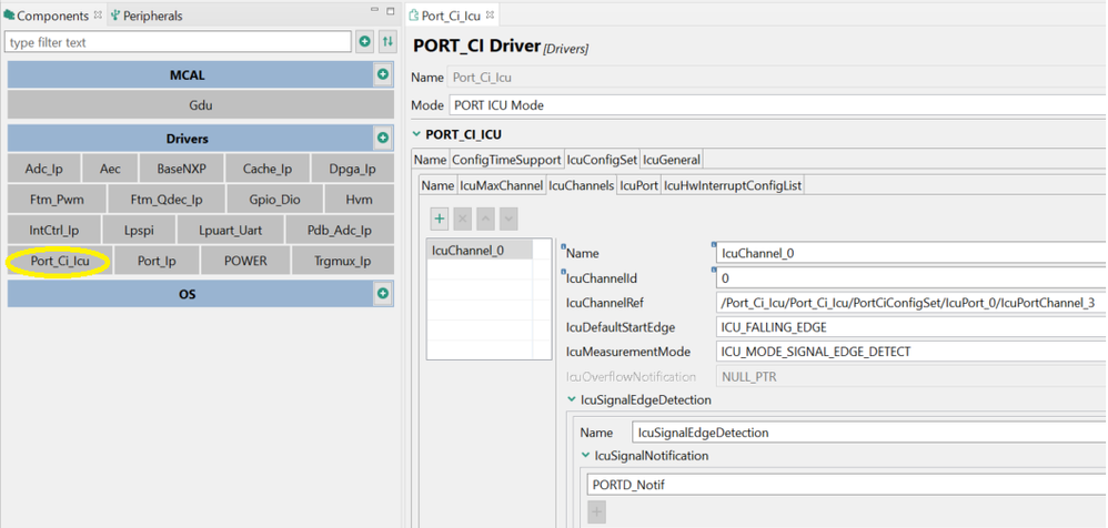

The interrupt from AE fault is carried out by detection of falling edge on PTD3, this needs to be set in RTD peripherals tool as well, a part of the setting is shown in Figure 15. See the detailed setting in RTD peripherals tool for the module Port_Ci_Icu.
The S32CT -generated configuration structure IntCtrlConfig_0 and the structure for PTD3 interrupt Port_Ci_Icu_Ip_3_Config_PB_BOARD_INITPERIPHERALS and the respective
RTD function is then called in src/peripherals/peripherals_config.c/MCUIntConfig().
Figure 15. S32M244 enabling PTD3 falling edge detection.
The LPIT channel 0 is employed to control the speed and motor current in a software task. LPIT channel 0 is configured to generate a periodic interrupt every 1 ms. The configuration by means of S32CT is as follows:
 Figure 16. S32M244 LPIT configuration.
The S32CT -generated configuration structure LPIT_0_InitConfig_PB_BOARD_INITPERIPHERALS and the respective RTD function is then called in src/peripherals/peripherals_config.c/MCULpitConfig().

4.3. Software architecture
Figure 17 presents the conceptual system block diagram of the BLDC Six-step control technique working in sensorless mode. This section is focused on the software design of the Sensorless algorithm based on the zero-crossing detection technique.
The application is optimized for S32M244 motor control peripherals to achieve the least possible core involvement in state variable acquisition and output action application. The motor control peripherals (FTM0, FTM3, PDB0, PDB1, ADC0, ADC1) are internally linked together to work independently from the core, and to achieve deterministic sampling of analog quantities and precise commutation of the stator field. The software part of the application consists of different blocks which are described below. The entire application behavior is controlled from a PC through the FreeMASTER run-time debugging tool.
The inputs of the control loop are the measured voltages and current on the power stage, in particular the phase/BEMF voltages, the DC bus current, and DC bus voltage.
From a control perspective, the block diagram can be divided into two logical parts:
  • Commutation control, where the phase voltages and DC bus voltage are used to calculate the actual position of the shaft. According to the identified position, the next commutation event can be prepared.
  • Speed/torque control, where the required shaft velocity is compared to the actual measured speed and regulated by the PI controller. The output of the speed PI controller is the duty cycle. The duty cycle is limited by the current PI controller and assigned to the PWM.
Figure 17. System block diagram.

4.3.2. Application data flow overview
Figure 18 explains the different application states. The figure consists of two interconnected parts:
  • The speed over time characteristic
  • The blocks in the lower part of the picture, which show the states of the application and the transitions between respective states
The application software has three main states: the alignment state, the open-loop start state, and the run state. In the run state, the BLDC motor is fully controlled in a closed-loop sensorless mode. After the initialization of the peripheral modules has completed, the software enters the alignment state. In alignment state, the rotor position is stabilized into a known position in order to create the same start-up torque in both directions of rotation. This is achieved by applying a PWM signal to phase C. Phases A and B are assigned with a duty cycle equal to zero; that is, they are connected to the negative pole of the DC bus. The value of the duty cycle on phase C depends on the motor inertia and load applied on the shaft. Such a technique aligns the shaft into position between phase A and B, which is perpendicular to both start-up flux vectors (vectors 0 and 3) generated by the stator winding, and therefore ensures the same start-up torque in both directions of rotation. The duration of the alignment state depends on the motor’s electrical and mechanical constants, the applied current (meaning duty cycle), and the mechanical load.
When the alignment time-out expires, the application software moves to the open-loop start state. At a very low shaft velocity, the BEMF voltage is too low to reliably detect the zero-crossing. Therefore, the motor has to be controlled in an open-loop mode for a certain time period. The very first vector generated by the stator windings needs to be set to a position 90° relative to the position of the flux vector generated by magnets mounted on the rotor. The alignment and first start-up vector are shown in Figure 18 . The duration of the open-loop start state is defined by the number of open-loop commutations. The number of open-loop commutations depends on the mechanical time constant of the motor, including load, and also on the applied voltage (duty cycle). The shaft velocity after an open-loop start-up is approximately 5% of nominal velocity. At a velocity approximately 5% of nominal velocity, the BEMF voltage is high enough to reliably detect the zero-crossing.
After a defined number of commutation cycles, the state changes from the open-loop start state to the run state. From here on, the commutation process based on the BEMF zero-crossing measurement takes place, and the control enters the closed-loop mode.
 Figure 18. Flow chart diagram of main function with background loop.

Figure 20  shows the application timing and the associated interrupts used for the commutation, zero-crossing and speed control. The grey boxes show the executed interrupt routines versus the phase voltage measurement.
The top row shows the interrupt that is activated when the ADC conversion sequence of BEMF voltage, DC bus current, and DC bus voltage has been completed. In this interrupt, the FTM0 timer counter value is saved as a BEMF measurement reference point. The zero-crossing detection algorithm is executed in each ADC0 conversion complete interrupt after a commutation event. Once the zero-crossing is found, the detection algorithm is disabled until the new commutation event occurs.
The second row shows the FTM0 timer counter interrupt generated at the time of the
commutation event. The time between each FTM0 timer counter interrupt is dependent on the actual speed of the motor. Channel of the ADC1 is reconfigured to reflect the change in the phase used for the BEMF voltage sensing.
The last row shows the LPIT channel 0 time-out interrupt generated every 1 ms. This interrupt is used for speed loop control and motor current limitation, executing PI controller functions.
