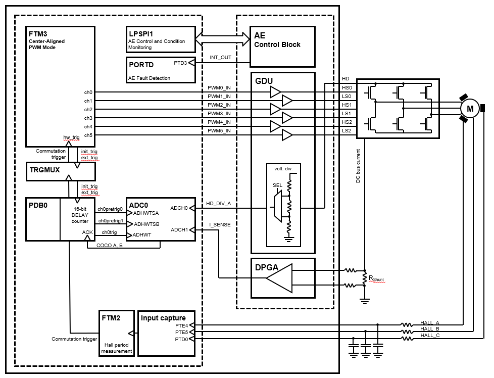

4.1.1. Module interconnection
As mentioned earlier, S32M24x consists of two parts: MCU and AE which are connected together via die-to-die (D2D) connections.
The SPI interface (part of D2D) serves for parameter settings and status monitoring of AE and the rest of D2D interface is used for motor control loop (e.g.: DC bus current reading).
The AE comprises modules vital for motor control such as Gate Driver Unit (GDU) and Digital Programmable Gain Amplifier (DPGA) which allow for using S32M244 in motor control applications with minimum of external components.
The GDU drives the power MOSFETs. The GDU is interconnected with the outputs of FTM via D2D connections.
The shunt resistor voltage drop signal (proportional to DC Bus current) is conditioned by the integrated DPGA which output is connected to the ADC via D2D connection.
DC Bus voltage is conditioned via integrated voltage dividers which outputs are connected to the ADC via D2D connection.
The MCU die modules involved in output actuation, data acquisition and the synchronization of actuation and acquisition, form the so-called Control Loop. This control loop consists of the FTM, TRGMUX, PDB, and ADC modules. The control loop is very flexible in operation and can support static, dynamic or asynchronous timing.
Each control loop cycle can be initiated either by FTM initialization trigger init_trig or by FTM external trigger ext_trig. While init_trig signal is generated at beginning of PWM cycle, ext_trig can be generated any time within the PWM period based on the value defined in the corresponding FTM Channel Value register CnV.

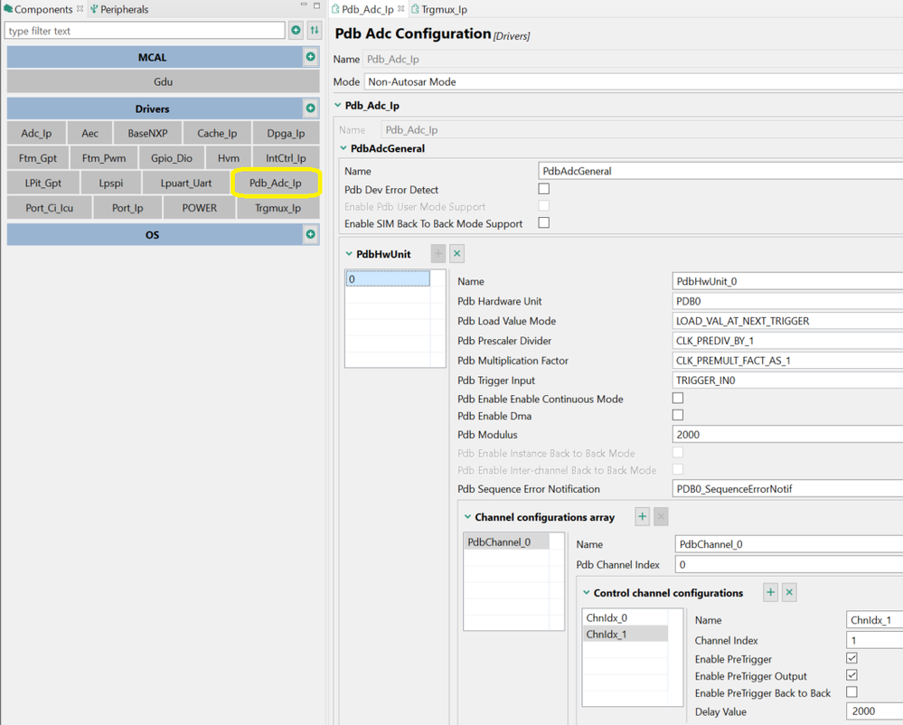

FTM trigger signal is routed to hardware trigger input of the PDB module through flexible TRGMUX unit. In S32M24x, there are two ADC modules and two PDB modules that work in pairs. This means that PDB0 is linked with ADC0 and PDB1 is linked with ADC1. The Hall sensor-based 6-step example only uses ADC0 and PDB0.
PDB pre-triggers ch0pretrigx are used as a precondition for ADC module. They are directly connected to ADHWTS ports to select ADC channels as well as order of the channels by configurable pre-triggers delays. When ADC receives rising edge of the trigger, ADC will start conversion according to the order defined by pre-triggers ch0pretrigx.
PDB pre-trigger delays must be properly set to allow reliable operation between PDB and corresponding ADC module. When the first pre-trigger is asserted, associated lock of the pre-trigger becomes active until corresponding conversion is not completed. This associated lock is released by corresponding ADC conversion complete flag ADC_SC1[COCOx]. This means that next pre-trigger can be generated only if the ongoing conversion is completed.
FTM2 module is used for commutation control. It is configured to schedule and force commutation events which are determined from the states of the Hall sensors.
Detailed description can be found in the S32M24x Series Reference Manual (see section References).
  Figure 3. S32M244 modules interconnection.

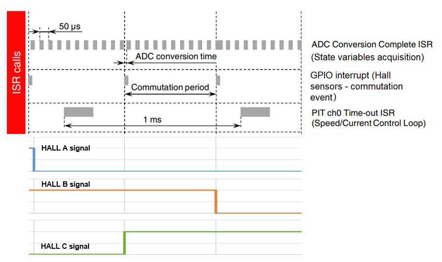

This section will discuss timing and modules synchronization to accomplish BLDC 6-step control on the S32M244 and the internal hardware features.
The timing diagram of the automatic synchronization between PWM and ADC in the BLDC application is shown in Figure 4.Figure4.PNGFigure4.PNG
Figure 4. Time Diagram of PWM and ADC Synchronization.

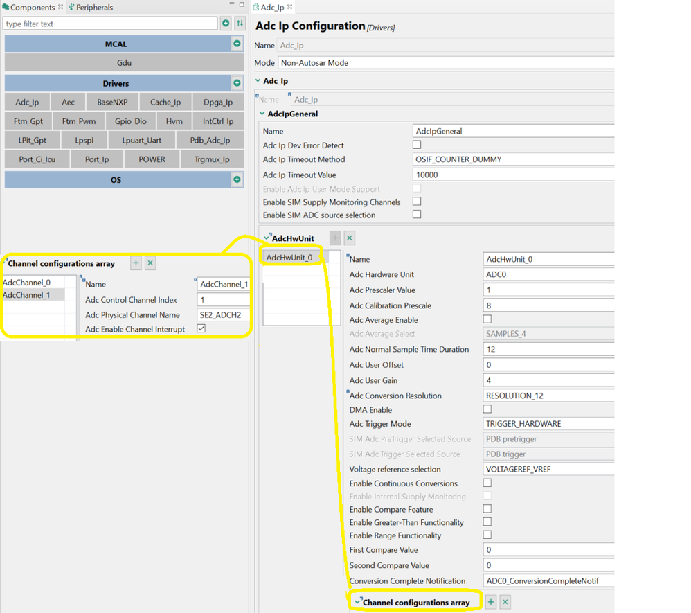

McuAdcConfig() ADC modules configuration
McuPdbConfig() PDB modules configuration

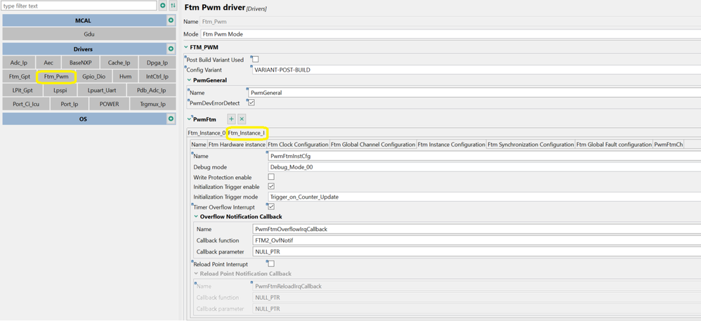

4.2.2.1. Center-aligned PWM mode
FTM3 instance is used in BLDC 6-Step motor control application to generate center-aligned PWM by three complementary channels pairs to control power MOSFETs.
The configuration is shown in Figure 6, FTM3 PWM frequency of 20 kHz is adjusted by Counter Period = 4000 taking 80MHz clock source frequency into account. Note that while Center-aligned mode is selected (up-down counter), the value written into FTM3 modulo register is half of Counter Period - this is done internally by the RTD. To protect power MOSFETs against short circuit, deadtime 0.5μs is inserted for each complementary channels pair in number of clock ticks 40 with default deadtime prescaler 1. This FTM3 configuration can be carried out by using S32CT, FTM_Pwm module, Figure 6
For detailed settings, please see all the settings tabs in Ftm_Pwm module in S32CT Peripherals tool.
  Figure 6. S32M244 FTM3 configuration in S32CT.
The double-buffered register FTM3_SWOCTRL is used to control the unipolar PWM pattern as discussed in 3.2. The FTM3_SWOCTRL register controls the PWM output by forcing selected channels into a defined state.  The PWM channel which is not SW-controlled is not forced into a SW-defined state but is PWM-controlled. The double-buffered values are applied at each commutation event triggered by FTM2 init_trig . To allow this triggering mechanism, Hardware trigger 0 is enabled in Ftm Synchronization Config tab, Figure 6. The following table shows the SWOCTRL values applied at a commutation event in a particular sector of the six-step commutation sequence.

4.2.2.2. Commutation for 6-step
In 6-step Hall-based control, the commutation depends on the change of Hall sensor state. The Hall sensors are routed to GPIOs which trigger interrupts on both raising and falling signal edges. In the interrupt service routine for GPIO the Hall signals are processed, new switching combination of the MOSFETs is stipulated based on Hall sensor signals and desired direction of rotation. The time which has elapsed between two Hall signal events is measured by FTM2. After each Hall (commutation event) FTM2 CNT (counter) value is recorded and FTM2 CNT is restarted.
Init trigger signal init_trig is internally routed to the FTM3 module trigger 0 input in order to perform commutation of the PWM pairs.
FTM2 module settings can be configured by S32CT as per Figure 7. In order to make use of RTD APIs, FTM2 is configured as FTM PWM but is used for measurement of time between Hall (commutation) events exclusively, the outputs of FTM2 are disabled. For detailed FTM2 configuration, please see all the configuration tabs as per Figure 7 in SW example.
Once the FTM2 setting is completed, RTD generates configuration structure Ftm_Pwm_Ip_BOARD_INITPERIPHERALS_UserCfg0 which, using the respective RTD API Ftm_Pwm_Ip_Init configures FTM2, this is encapsulated in function MCUFTMConfig, which can be found in the SW example in .../src/Peripherals/peripherals_config.c.
Figure 7. FTM2 configuration.

4.2.4. Programmable delay block (PDB)
The Programable Delay Block (PDB) is intended to completely avoid CPU involvement in the timed acquisition of state variables during the control cycle. The PDB module contains a 16-bit programmable delay counter that delays FTM3 initialization trigger and schedules ADC channels sampling through PDB pre-triggers delays. When FTM3 initialization trigger is detected on the PDB0 input, PDB0 generates hardware signal to trigger ADC0 channels in order defined by pre-trigger delays, Figure 9.
 Figure 9. PDB pre-triggers and trigger output.
PDB pre-trigger delays can be set independently using CHnDLYm registers. Since the PDB0, PDB1 and FTM3 modules are synchronized and share the same source frequency 80MHz, values of the CHnDLYm registers are set using the same time base as for PWM. The following table shows all PDB0 pre-triggers used in BLDC six-step motor control application.
Table 5. PDB0 pre-triggers
State variable
PDB pre-trigger
CHnDLYm value [ticks]
Relation to PWM
DC bus current
pdb0_ch0_pretrig0
0
At beginning of the PWM
DC bus voltage
pdb0_ch0_pretrig1
pdb_delay
In the middle of the PWM
DC bus current measurement is triggered every PWM cycle at beginning of the PWM period by pdb0_ch0_pretrig0. This delay is static value defined only once at the initialization phase. The DC Bus voltage is measured in the middle of the PWM period.
General settings of the PDB module such as clock pre-scaler, input trigger source, loading mechanism for double buffered registers as well as operation mode for pre-triggers can be configured by means of S32CT as shown in Figure 10, for details, see the PDB configuration in the SW example.
 Figure 10. S32M244 PDB module and pre-triggers configuration.
RTD generates configuration structure PdbHwUnit_0_BOARD_INITPERIPHERALS  for appropriate PDB registers. This configuration is loaded calling .../src/Peripherals/peripherals_config.c/McuPdbConfig().

4.2.5. Analog-to-digital converter (ADC)
The S32M244 device has two 12-bit Analog-to-Digital Converters (ADCs). These are 32-channel multiplexed input successive approximation ADCs with 16 result registers.
The ADC0 instance is used in the SW example and is triggered by PDB0. ADC channels are sampled in the order defined by PDB pre-triggers. When the first pre-trigger is asserted, associated lock of the pre-trigger becomes active waiting for the conversion complete flag COCO generated by the corresponding ADC channel. This sequence is repeated for each PDB pre-trigger and ADC channel couple.
The configuration in S32CT is shown in Figure 11, see the SW example for details.
   Figure 11. S32M244 ADC0 module configuration.
ADC0 channel 0 measures DC bus current, ADC0 channel 1 measures DC Bus voltage.
RTD generates module configuration structure  AdcHwUnit_0_BOARD_INITPERIPHERALS, which takes effect calling the respective RTD API in function .../src/Peripherals/peripherals_config/McuAdcConfig().

4.3. Software architecture
Figure 18 presents the conceptual system block diagram of the BLDC Six-step control technique working in Hall sensor-based mode.
The application is optimized for S32M244 motor control peripherals to achieve the least possible core involvement in state variable acquisition and output action application. The motor control peripherals (FTM2, FTM3, PDB0, ADC0) are internally linked together to work independently from the core, and to achieve deterministic sampling of analog quantities and precise commutation of the stator field. The software part of the application consists of different blocks which are described below. The entire application behavior is controlled from a PC through the FreeMASTER run-time debugging tool.
The inputs of the control loop are the measured voltages and current on the power stage, in particular the phase/BEMF voltages, the DC bus current, and DC bus voltage.
From a control perspective, the block diagram can be divided into two logical parts:
  • Commutation control, where the signals from Hall sensors are used to determine the actual position of the shaft. According to the identified position, the next commutation event can be prepared.
  • Speed/torque control, where the required shaft velocity is compared to the actual measured speed and regulated by the PI controller. The output of the speed PI controller is the duty cycle. The duty cycle is limited by the current PI controller and assigned to the PWM.
Figure 18. System block diagram.

4.3.4. Application timing and interrupts
Figure 20  shows the application timing and the associated interrupts used for the commutation, Hall sensor processing and speed control. The grey boxes show the executed interrupt routines versus the phase voltage measurement.
The top row shows the interrupt that is activated when the ADC conversion sequence of DC bus current, and DC bus voltage has been completed.
The second row shows the GPIO interrupt caused by Hall sensors state change generated at the time of the commutation event. The time between each GPIO interrupt is measured by FTM2 counter.
The last row shows the LPIT channel 0 time-out interrupt generated every 1 ms. This interrupt is used for speed loop control and motor current limitation, executing PI controller functions.
 Figure 20. Application timing and interrupts
