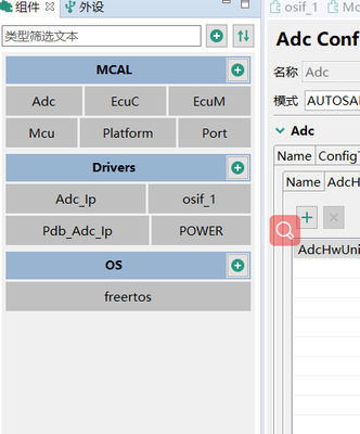

when i use the s32k1xx RTD V1.01 to configure a ADC driver,i import the mcal Adc,Drivers Adc_Ip and Pdb_Adc_Ip as show in the following figure,so what the meaning of the suffixation Ip including the Ipw in source file Adc_Ipw.c
