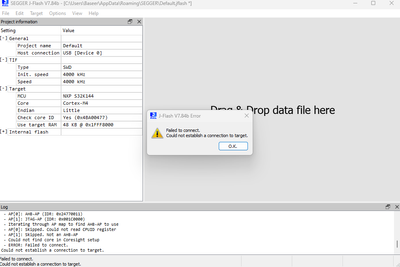

baseerahmadpiracha
Hi @lukaszadrapa
I have tried to execute 1_Configure_part_and_Load_keys project on S32K144 and after programming when I tried to program again I am facing this error can you please guide what can be the possible reason?
4,856 Views
lukaszadrapa
There's one problem with J-Link - when you load new project to the device by J-Link, it tries to perform mass erase. However, the mass erase is not allowed if CSEc is enabled. The CSEc needs to be disabled by CMD_DBG_CHAL and CMD_DBG_AUTH command (you need to know MASTER_ECU_KEY for this) and after that the mass erase is possible.
If Multilink or OpenSDA interface from Pemicro is used, then the flash is erased block by block, mass erase is not used, so it is possible to load new project to the flash even if CSEc is enabled.
As far as I know, Segger didn't change it until now. You can try to contact them if needed.
Lukas
4,854 Views
baseerahmadpiracha
@lukaszadrapa @Keane I was able to resolve the issue by connecting the RESET pin of microcontroller with ground and when I clicked on connect Jlink showed that microcontroller is resetting. And after removing the reset pin from ground microcontroller started working fine. Thanks for the time
4,867 Views
