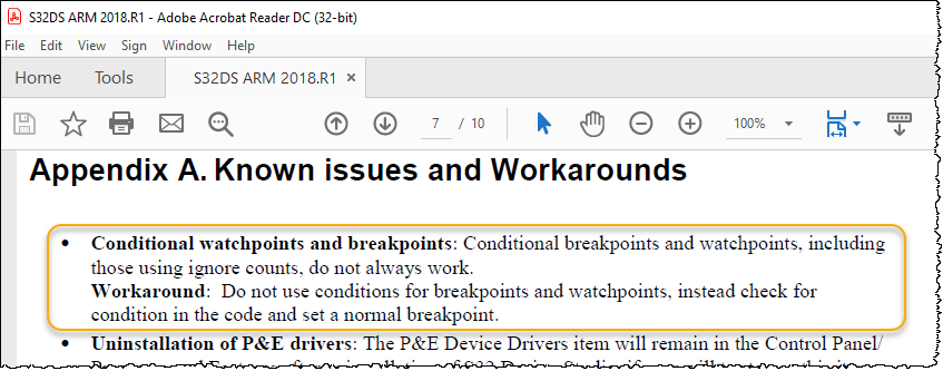

I'm tryng to put a watchpoint on a variable named Time_ms.
I would like stop debug when the value 0 it's written on this variable.
Putting watchpoint like attached image, the debugger is stopped at each write of this variable, not only when the value 0 is written.

Hi Francesco,
I'm afraid it's due to this known issue:
Conditional watchpoints and breakpoints.pngConditional watchpoints and breakpoints.png
Sorry for the inconvenience we bring you!
Robin
