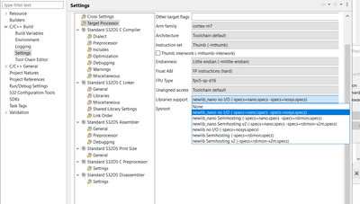

Hi there ,
currently iam using S32 studio , for debug purpose  i need print on console can you please guide me .
printf statement is not working .
2,773 Views
Robin_Shen

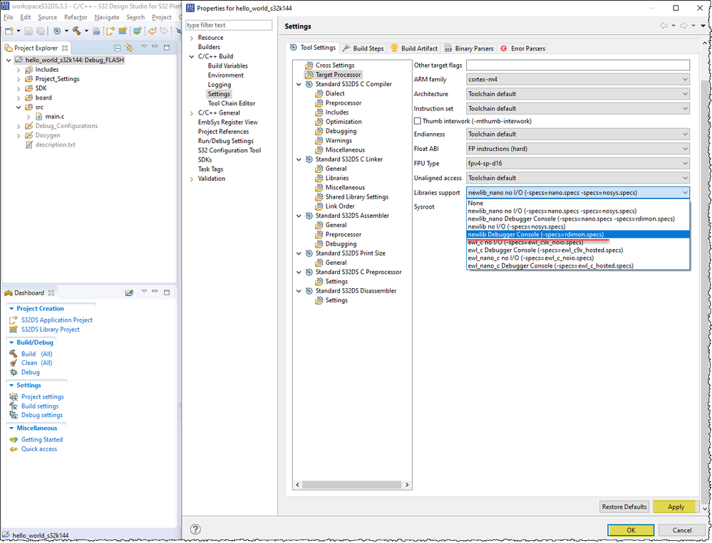

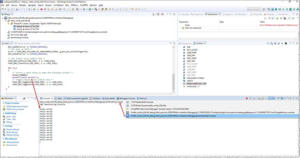

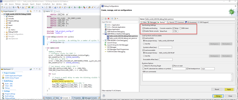

Hi Teja114,
Please follow the steps shown below:

Hi Teja114,

Hello @Robin_Shen ,
I am not seeing such option in settings to select debugger console. Could you please help me to fix this.
