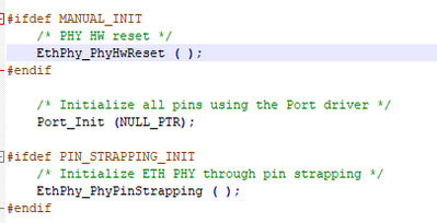

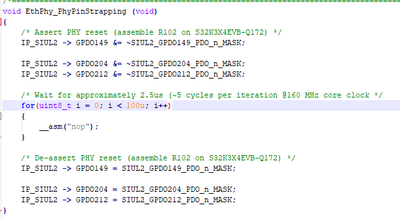

For current status, we just can connect to PHY through pin strapping for S32K388 board
Nhi_Nguyen_0-1709791829169.pngNhi_Nguyen_0-1709791829169.pngNhi_Nguyen_1-1709791870762.pngNhi_Nguyen_1-1709791870762.pngNhi_Nguyen_2-1709791897215.pngNhi_Nguyen_2-1709791897215.png
After that, PHY is in RGMII, 1Gbps.
To configure MDC, you just need to configure pin MDC as output. Clock provided from GMAC through this pin.
