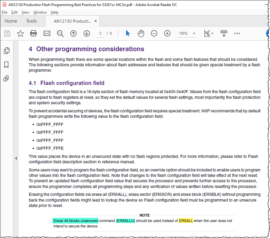

What's the difference between the following erase method?
I can't get the difference between this two comand,  wish your detail description!!
thanks
2,003 Views
Robin_Shen
Hi kui wu,
AN12130, Production Flash Programming Best Practices for S32K1xx MCUs - Application Note
For more detail please read the "37.5.9.11 Erase All Blocks command" and "37.5.9.13 Erase All Blocks Unsecure command" of S32K-RM.
Robin

814420552
hello,
      when execute this two command it will erase the P-Flash code, If it's erased, isn't it that the application won't run? Need to download the app again。
2,003 Views
Robin_Shen
Hi kui wu,
If it's erased, the MCU is blank no application run. The reset pin will toggle. Need to download the app again.
