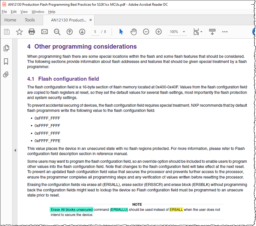

What's the difference between the following erase method?
I can't get the difference between this two comand,  wish your detail description!!

Hi kui wu,
AN12130, Production Flash Programming Best Practices for S32K1xx MCUs - Application Note
For more detail please read the "37.5.9.11 Erase All Blocks command" and "37.5.9.13 Erase All Blocks Unsecure command" of S32K-RM.

hello,
      when execute this two command it will erase the P-Flash code, If it's erased, isn't it that the application won't run? Need to download the app again。

Hi kui wu,
If it's erased, the MCU is blank no application run. The reset pin will toggle. Need to download the app again.
