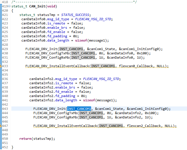

I use the CAN0 and CAN2but after I initialize the CAN driver( CAN_Init() function) the APP_TASK can not work, the prvCheckTasksWaitingTermination() is executed for ever.  If I disable CAN_Init() function, APP_TASK can work normally.

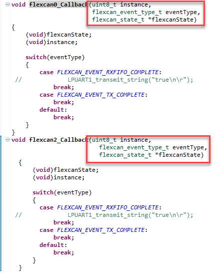

First, I would like to apologize for the late response. I imported your project and I noticed a couple of things that got my attention.

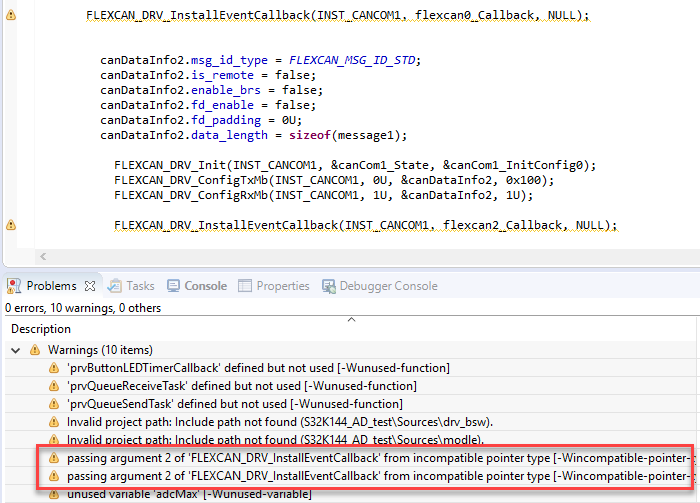

The following warnings.
Your callbacks only receive three parameters.
However, the type flexcan_callback_t receives 4 parameters, you are missing the buffIdx.
Also, in your function CAN_INIT, you are initializing two times the same instance.
