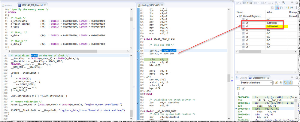

S32K146 ECC initializer, why not initialize stack space?
2,035 Views
Robin_Shen
It already initialize the whole SRAM including stack space

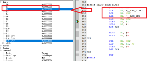

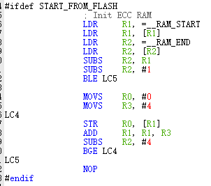

In keil's environment, the stack is not initialized with ECC. why?
