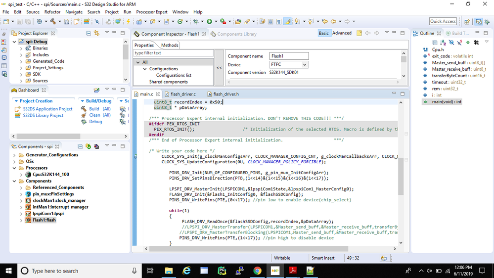

intern_praveena
Is this code correct to read device id using spi flash?if wrong please anyone correct itScreenshot (119).png
13 Replies
9,555 Views
intern_praveena
what is the format to transmit data, bcz there is some formate lke command + data + register address.I dnt know that format?

jorge_a_vazquez
Hi Praveena F
This is a common format when you work with memories, first, you have to send the specific command that could be WRITE, READ, READ ID, etc. then you send the data in the size required and finaly you specify the address of the register.
As I mentioned before this is memory depended and you need to implement the code with the format that the datasheet of the memory specify.
Jorge Alcala
9,555 Views
razva_tilimpea
You try to use an external flash via SPI? If yes this approach is wrong because FLASH driver provided in SDK is just for internal flash.
Please use LPSPI driver and send the right commands to your external flash based on datasheet.
Razvan

intern_praveena
yes i did wrong,i m using only LPSPI but i dnt know the command to read
