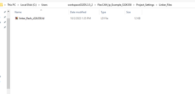

In the Project_Settings of project in workspace, inside the Linker_Files should have the .ld file like below:
The tool should automatically coppy the .ld file from C:\NXP\S32DS.3.5_2\S32DS\software\PlatformSDK_S32K3\RTD\Platform_TS_T40D34M30I0R0\build_files\gcc and link it in DS. Not manually coppy it.
Please help me to check again.

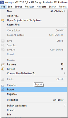

The S32DS\software\PlatformSDK_S32K3\RTD is the RTD package that you install in DS through updatesite one. It should be async with DS project for compiling and running tests.
Please help me to share your project.
