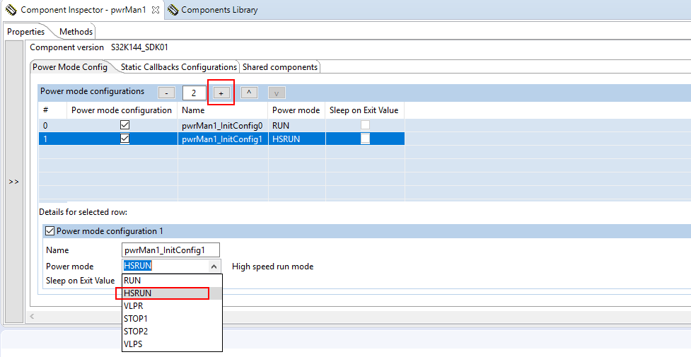

1. How to set HSRUN mode?
Please add a new component in Processor Expert and new a Power mode configurations as below.
Then in the code call ROWER_SYS_Setmode, and fill in the power mode index which indicates the HSRUN mode, in my case it's 1.

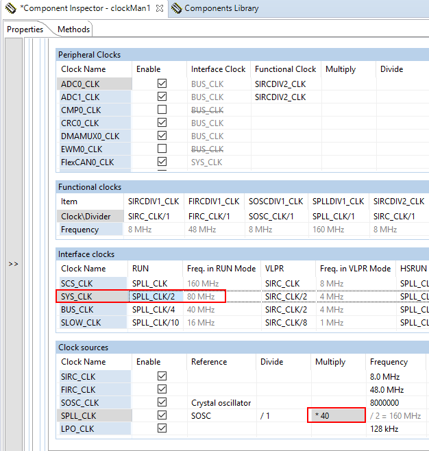

2. How to set RUN mode to 80MHZ from 48MHZ?
Please set SPLL_CLK - Multiply to 40 and choose SYS_CLK RUN mode to SPLL_CLK/2.

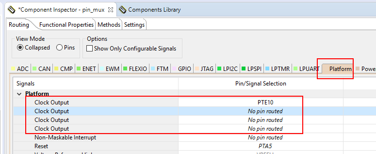

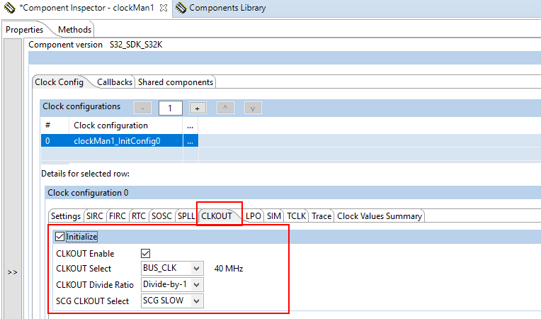

3. How to know your current system clock frequency?
You can use the clock output feature.
 In PIN_MUX component you can set maxim 4 pins as clock output
Then go to clock manager component, choose the clock source you want to monitor
Hope it will help. Any question please feel free to reply.

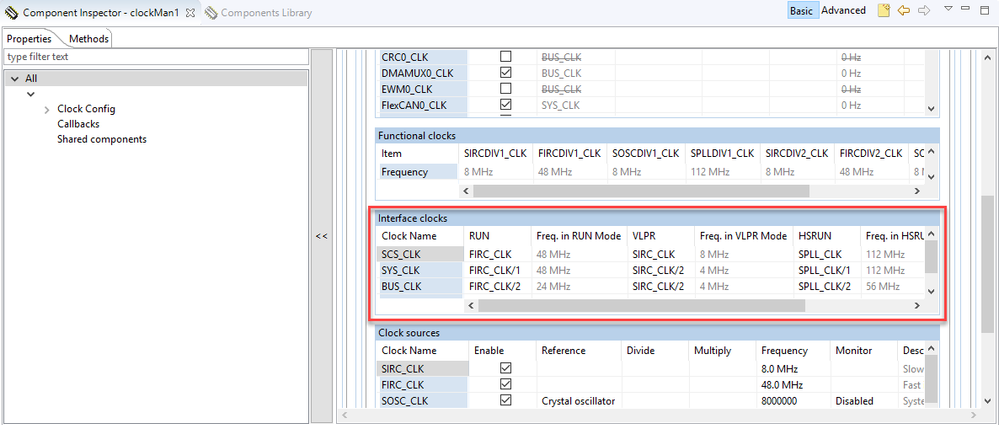

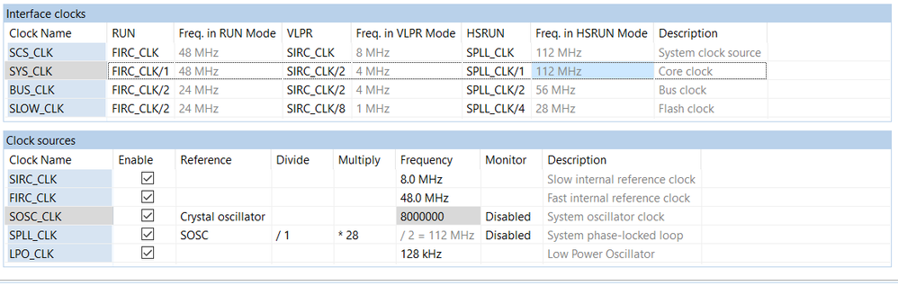

pierpaolo_dini
Hi Victor,
First of all, thank you for your answer.
However, I don't understand where I can explain that my code can run in normal or highspeed mode.
Also because from the component inspector I can't change the frequency value (48 MHz for Normal Mode and 112MHz for High Speed are values that I can't decide).
I mean that in the SYS_CLK row of the interface clocks table I can't change the values indicated (at least I think it doesn't give me any option and I don't do it).
Maybe in the table below (Clock Sources) I can change the values. But if I try, it shows me a lot of Warnings (?).
Thanks for your attention,
Pierpaolo.
