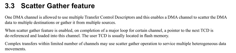

shivamshankarg

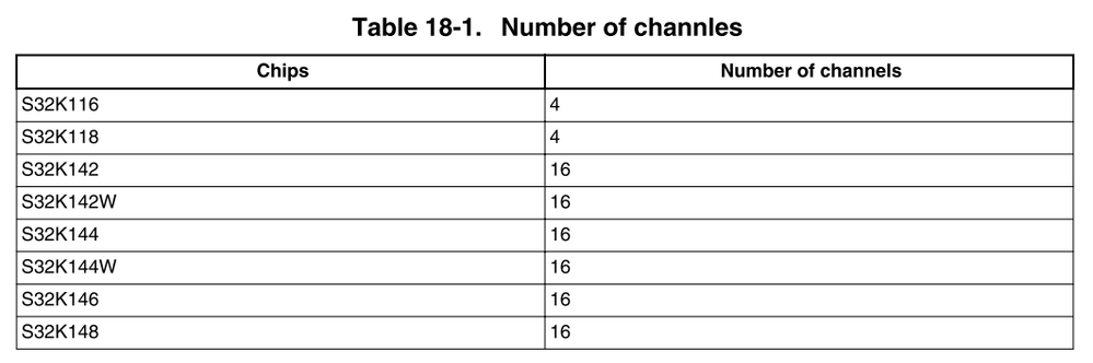

Hello lukaszadrapa‌ As written in 3.3 scatter gather features one DMA channel is allowed to use multiple transfer control descriptors so just want to ask how many transfer control descriptors is available in eDMA.
2,859 Views
lukaszadrapa
Hi Shivam,
there are 16 DMA channels on S32K144:
Scatter-gather allows you to load endless number (theoretically, of course) of new descriptors to a channel. These new descriptors are supposed to be stored somewhere in flash or RAM and DMA engine will load them automatically when scatter-gather is enabled (you are just providing pointer to them).
Lukas
