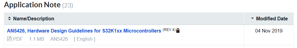

Hello Matthew,
Is it your own custom board?
If so, could you check the SWD connections?
32-bit Automotive General Purpose MCUs | NXP
Have you tried the probe with other S32K1xx boards?
If this is an EVB board, can you tried with OpenSDA?
BR, Daniel
