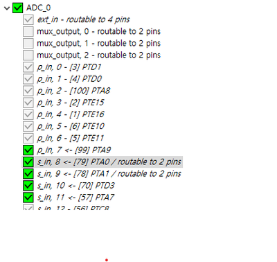

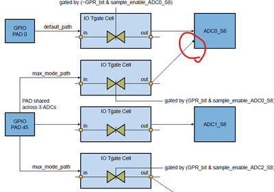

Even though ADC0 Standard Channel 8 is set up normally
There is a problem reading GPIO PAD 45.
The value of ADC0 Standard Channel 8 is always the same as ADC1 Standard Channel 8.
How can I solve the problem?

Thank you for the report.
And sorry for the inconvenience we bring you!
The problem of Siul2_Port_Ip_WriteDCMConfiguration has been reported to the RTD team before. What version of S32K3 RTD are you using now? The fix version may not been released yet, so the customer needs to manually modify it temporarily.

Thank you for your quick reply.
I checked that it works normally after modification.
The version I am using is as follows.
SDK Version : PlatformSDK_S32k3_2022_07
