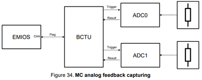

_Leo_
There is no the specific module synchronization that you require for the S32K312. But you could refer to Adc_Sar_Bctu_Ip_example_S32K312 and Emios_Pwm_Ip_Example_S32K312 that are included in S32DS 3.4 with RTD 2.x.x. You can have multiple IDEs.
Additionally, you could refer to the 4.2.4. Analogue data capturing section from AN13767 and its respective Application Software in MCSPTE1AK344 page:
Hope it helps you.

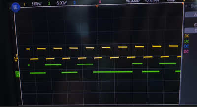

S32k1
Hi Community,
I have configured Adc in bctu control mode and the conversion of the channels are happening.
In order to measure the adc at the mid point of pwm active dutycyle,
  1. Configure the Dummy PWM Signal:
    • The dummy PWM signal is correctly set to half the period of the original PWM signal. This will help you achieve the desired delay for midpoint measurement.
  2. Set Up TRGMUX:
    • Configured the TRGMUX to route the eMIOS channel (e.g., TRGMUX_IP_INPUT_EMIOS0_IPP_CH3) to the BCTU trigger input (TRGMUX_IP_OUTPUT_BCTU_TRG23).
  3. Trigger BCTU:
    • Used the dummy PWM signal to trigger the BCTU at the midpoint of the original PWM signal’s on-time.
  4. BCTU to ADC:
    • The BCTU is configured to start the ADC conversion upon receiving the trigger.
      Also when ever there is any pwm dutycycle update I need to change the delay point in such a way that it should be at the mid of pwm active dutycycle, for that i have used Bctu Tigger notification callback to update the trigger point.
      But when i output the result in DSO the signal waves are showing not as expected. Yellow - PWM Output
      Green  - BCTU trigger( should be at the mid point), also for some signals it is missing.
