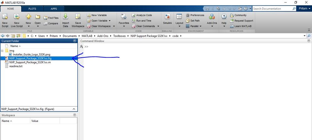

6. then clicked on "NXP_Support_package_s32k1xx.fig" as shown in imagembdt1.JPG

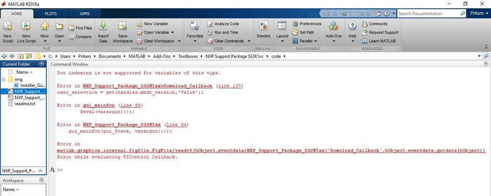

8. When i clicked on option 1 mentioned in the figure above, i.e. "Go to NXP Download Site", i get an error in command window shown below and it doesn't proceed furthur.
the error is as follows:
Dot indexing is not supported for variables of this type.
Error in NXP_Support_Package_S32K1xx>Download_Callback (line 107)
user_selection = get(handles.mbdt_version,'Value');
Error in gui_mainfcn (line 95)
f;
Error in NXP_Support_Package_S32K1xx (line 34)
gui_mainfcn(gui_State, varargin{:});
Error in
matlab.graphics.internal.figfile.FigFile/read>@(hObject,eventdata)NXP_Support_Package_S32K1xx('Download_Callback',hObject,eventdata,guidata(hObject))
Error while evaluating UIControl Callback.
 Please provide a solution for this issue...

You need to run execute *.m-file not the *.fig-file.
Once you install the toolbox from Add-on you can simple type in the command line the NXP_Support_Package_S32K1xx and the installer guide should start correctly.
Hope this helps!

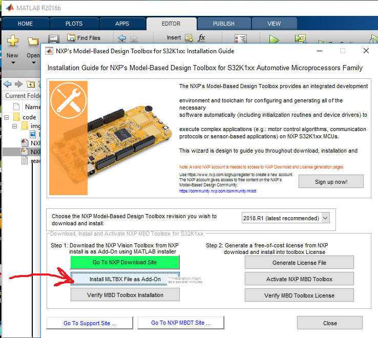

However, i am unable to find path for .mltbx file in the zip file which i downloaded from NXP website
Please let me know the path for .mltbx file to be selected after clicking on "Install MLTBX file as Add-on"

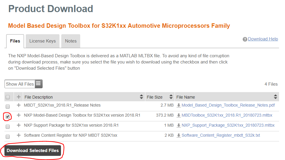

The link towards download location is: https://nxp.flexnetoperations.com/control/frse/download?element=10221477
For downloading the toolbox:
  1. Select the checkbox near the file
  2. Click on Download Selected Files button

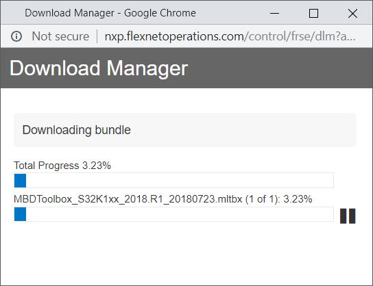

You should see this in your browser:
You you don't, then probably you need to configure the browser to allow pop-ups.
