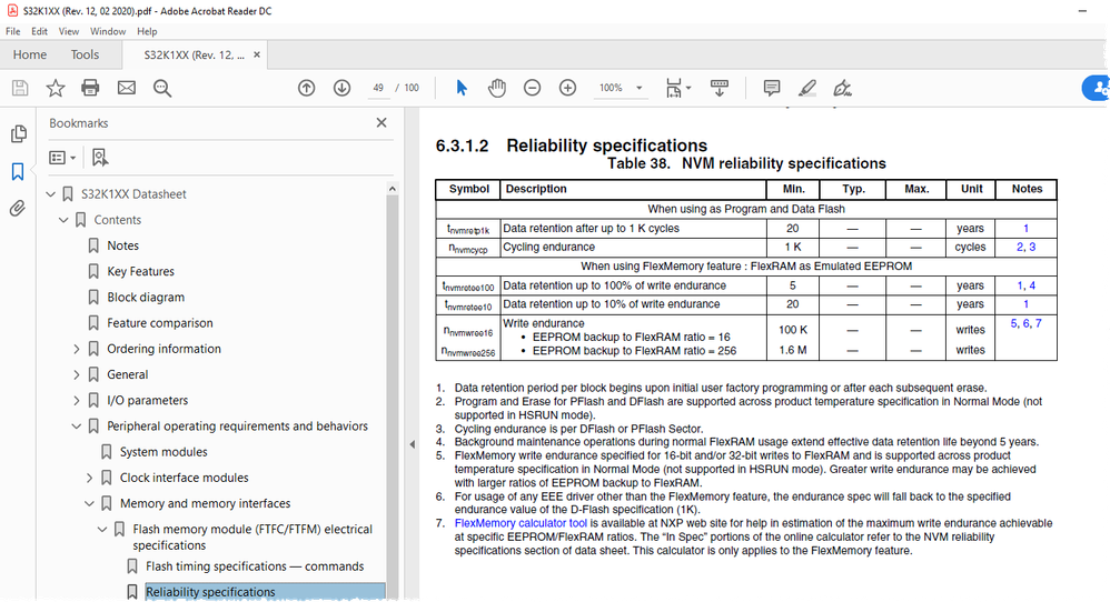

hello,
   how many s32k14x program flash 's and erase & write times ?   whether can provide the datasheet or where I can get the parameters?
thansk a lot
1 返信
1,245件の閲覧回数
Robin_Shen
Hi kui wu,
Please check the "Table 38. NVM reliability specifications" of S32K1xxDS.
