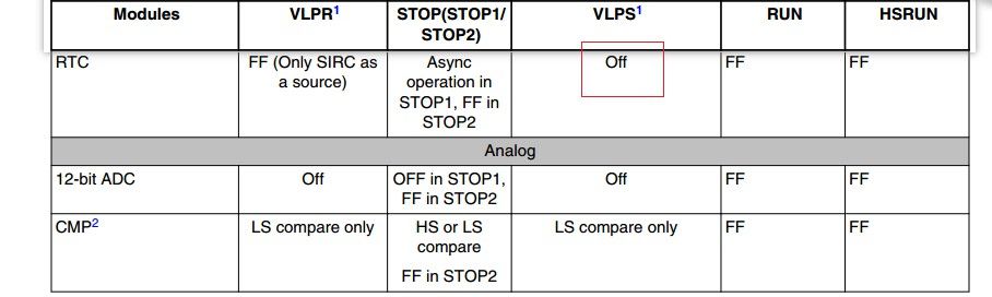

2. on P955
In powermanage, RTC in VLPS mode is off state,off Module and clock sources are disabled, and off represents the block clock source prohibition
Snipaste_2018-07-02_14-11-34.jpgSnipaste_2018-07-02_14-12-23.jpgTherefore, I don't know whether RTC can work in VLPS mode, so I have done relevant experiments to prove whether VLPS continue to time from run-> lvps-> RUN ,
Whether to continue timing in mode on vlps
I have shown that both external crystal oscillations and internal real-time clocks within the internal clock source are valid

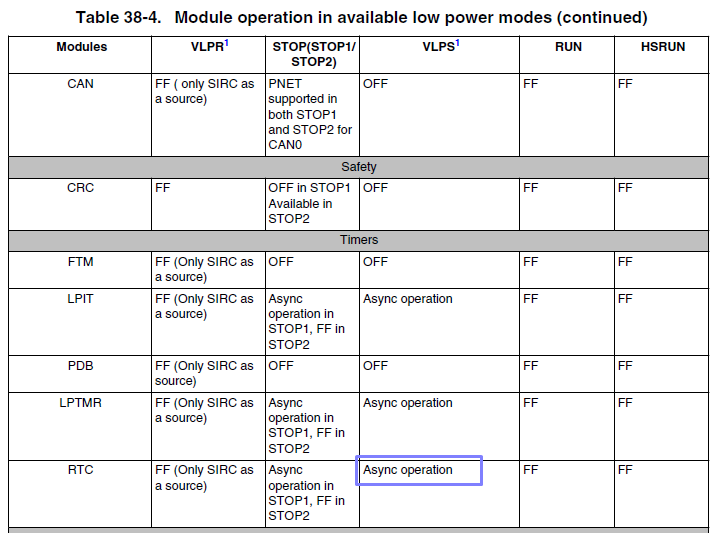

danielmartynek
Please use S32K1xx_RM_r.7.
The table has been updated.

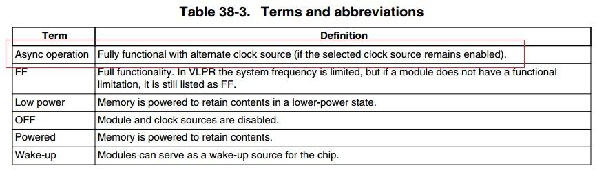

thanks for your reply,I wonder what that means about Async operation ,
3,306 Views

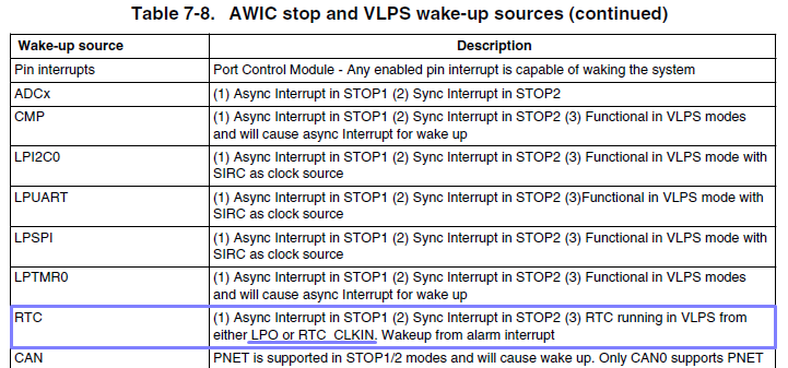

danielmartynek
Please refer to Table 7-8, S32K1xx_RM_r7.
All the other clock sources (LPOCLKS[RTCCLKSEL]) are gated off in VLPS.
