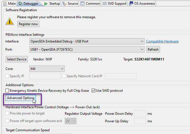

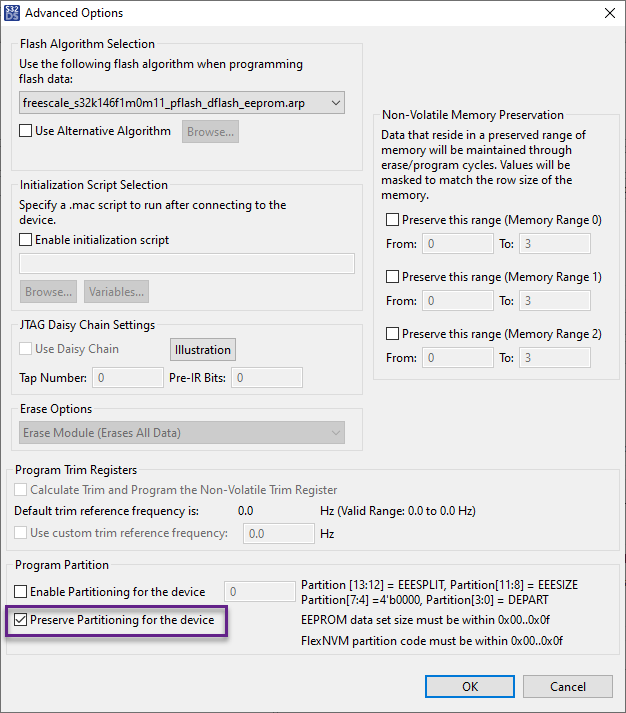

Hi @JyotiRanjan,
If you use PE Micro, you can preserve the partitioning:

JyotiRanjan
Thanks a lot sir,
Now I am getting my partition even though I change in my code.
