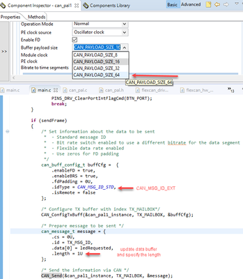

Please Share the Basic CAN Extended Code for both Tx and Rx Functionalities.
or else Please Suggest the Required Changes in can_pal_s32k144 Code to Modify into Extended CAN Code.

what do you mean by CAN Extended Code?
Sending/receiving message with extended ID or CAN FD message with bigger payload (up to 64bytes) or both, or something else..

Actually i need both CAN Extended ID Sending/Receiving Code and Also CAN FD(up to 64bytes) Sending Code
Please Share the Code and Configurations Required to Achieve For both

if you are referring to can_pal example, then modification is simple. CAN FD is already enabled and CAN FD message is prepared/send, with std ID. To send ext ID and more data bytes change
To receive extended ID message just modify .id type as above

Thanks for the Reply,
It's working fine.
