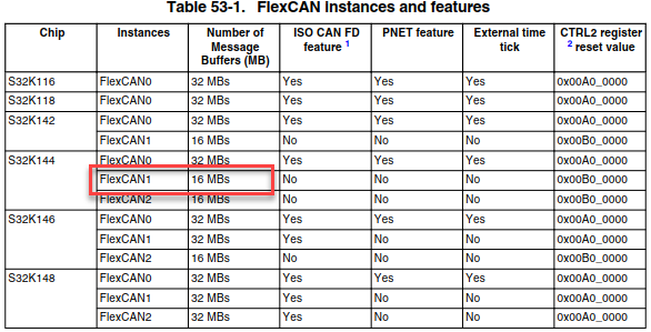

S32K can1 not work ,can0 is ok.My mcu is s32k144-64pins . The following is my code :

 __IO uint32_t RXIMR[CAN_RXIMR_COUNT];
CAN_RXIMR_COUNT =32 ;but when CAN_RXIMR_COUNT>16 , it is wrong;
3,076件の閲覧回数
PetrS
yes, it could be. There are just 16 MBs (and so RXIMRs) implemented on the FlexCAN1 module.
FlexCAN0 has 32 MBs.
BR, Petr
3,076件の閲覧回数
PetrS
Could you please specify in more details what is not working on CAN1? It is used to send or receive frames? There is no MB prepared for RX or TX.
Do you use own board? How is the module connected to the bus?
BR, Petr
