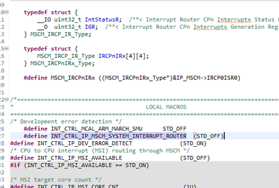

I'm trying to configure pwm module and build the project. The build is getting failed due to below
/main/main.c:112:5: error: implicit declaration of function 'IntCtrl_Ip_ConfigIrqRouting' [-Werror=implicit-function-declaration]
112 | IntCtrl_Ip_ConfigIrqRouting(&IntCtrlConfig_0);
SDK used is 3.0.0
Please help to resolve it
1,630 Views
Robin_Shen
Function 'IntCtrl_Ip_ConfigIrqRouting' does not exist in RTD3.0.0, please call IntCtrl_Ip_Init.

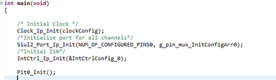

hi @Robin_Shen ,
Thank you for your response.
We are already calling IntCtrl_Ip_Init(), but the ISR is not getting invoked. We are trying to test UART and PWM modules through ISR.
