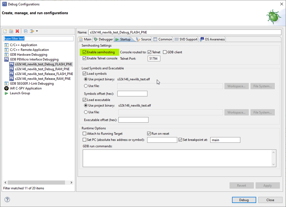

Hello, please ask some questions about s32k146.
When selecting Libraries support, selecting newlib Debugger Console will cause the program to enter HardFault.
But choose newlib_ Nano no I/O will not enter HardFault, and the program is normal. Why?
1,783 Views
jiri_kral
do you have enabled semihosting console in Debug Configurations for Newlib Debugger Console library?
