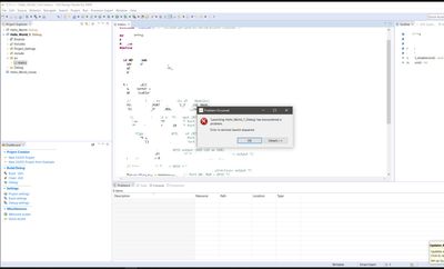

Hello there
Having trouble with an error in while i am trying to Debug.  can someone please help me figure it out.

Hi@akhilranga
It looks like you didn't disconnect the last debug connection and started a new debug.
You need to disconnect the last debugging connection before starting a new one.

akhilranga
Thanks for that. Actually i diconnecetd my previous debugging  session and tried it  but continiously i have been getting the same error. So, i restarted my system and then it started working.
