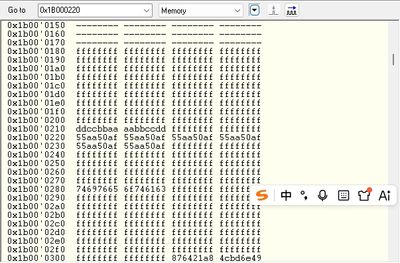

lukaszadrapa
Hi @hangwu
I'm sorry for delayed response.
Are you still in CUST_DEL life cycle? Easiest option to confirm this - please send me a screenshot of memory at 0x1B00_0220 - 0x1B00_026F.
The catalogs can be formatted only in CUST_DEL life cycle, so this could be the root cause. Next failing commands (keyelementset...) could be just a consequence because the catalogs are not formatted.
Lukas

hangwu
Thank you for your reply. Based on this memory screenshot, can you identify any issues?
6,824 Views
lukaszadrapa
Well, there's no problem with the life cycle. Your device is still in CUST_DEL.
Could you show me how are NVM and RAM catalogs defined?
