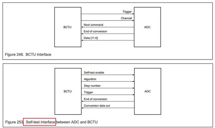

When I read the S32K3xx Referer Manual (actual device is S32K358), I found interface between BCTU-ADC and BCTU-ADC_self-test are different, is there some demo code or project teaching how to use "BCTU triggering ADC self-test".

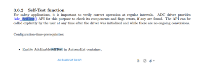

If you're using RTD's product, in the ADC module we provided API calls Adc_SelfTest(), which is mentioned in ADC User manual as call at any time after driver was initialized and there are no ongoing convertions:
